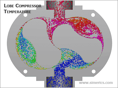

It is a turbo "turbine" belt driven. A supercharger usually refer to a lobe compressor:
