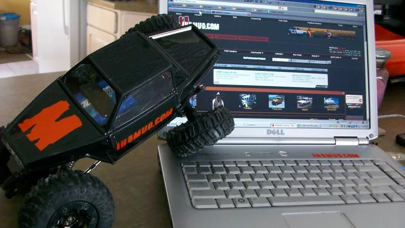

did some testing last nite at a neighbor's indoor garden and it works nice....lookin at a Slingshot or GC2 chassis tho....not quite convinced yet, but close :) (WILL have the rear 4-linked tho...that's a must...)

no LC bodies yet...at the rate my changes go, it's gonna just be buggy :)
645MG ordered today too....may as well...
have the new Pitbull 2.2 tires coming too....not sure if i can get rims to work with this chassis, or if I gotta start with a new Axial :)
