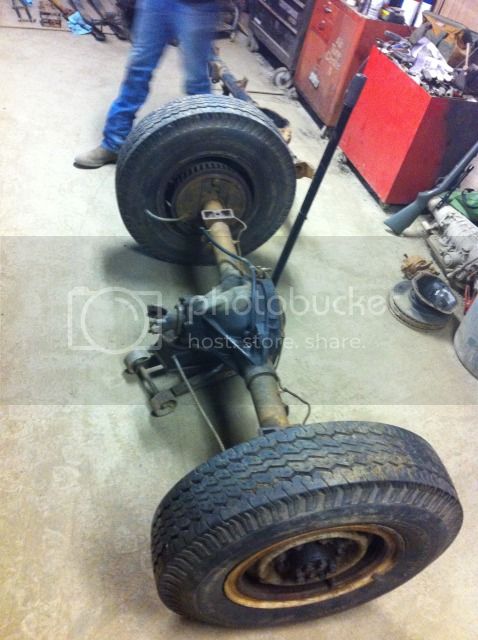

The plan at the time was to find a Dana 70, well thought I Had found one ended up being a sf 14 bolt:bang: Ended up finding a 14 bolt for cheap:grinpimp:
index.php
To get from there ^^^ to here VVV was a bit of a challenge, ended up tying it to a tree and drove the my Tacoma out from under it.
Not to bad for 150 bucks, but had 3.73s which is no bueno

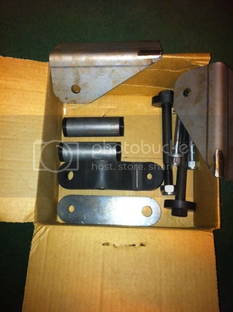

Got some parts in:grinpimp:
Stuff from sky manufacturing
Barnes 4wd stuff

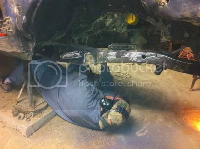

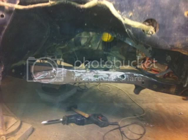

Me and buddy went to work on cutting off the ifs, NEVER again will we do this with cutoff wheels. I will use a plasma cutter next time or cut off the frame at the body mount and build foward.
index.php
index.php
index.php

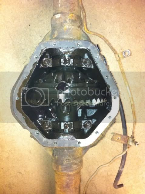

Reason I'm running 4.10s, they were free:flipoff2:
index.php
14 bolt shave
index.php
index.php
