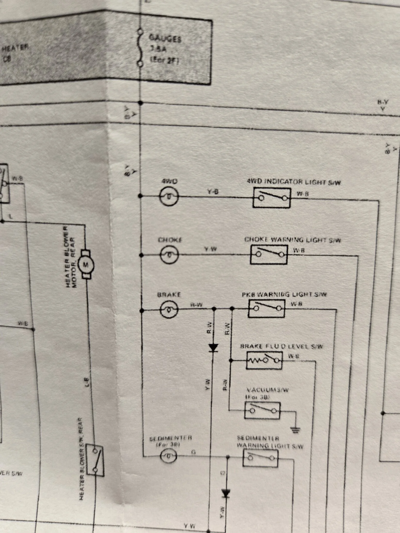

Ive got a wiring diagram for a 1983, but it doesn't seem to match what I have. Maybe someone knows something that could help.

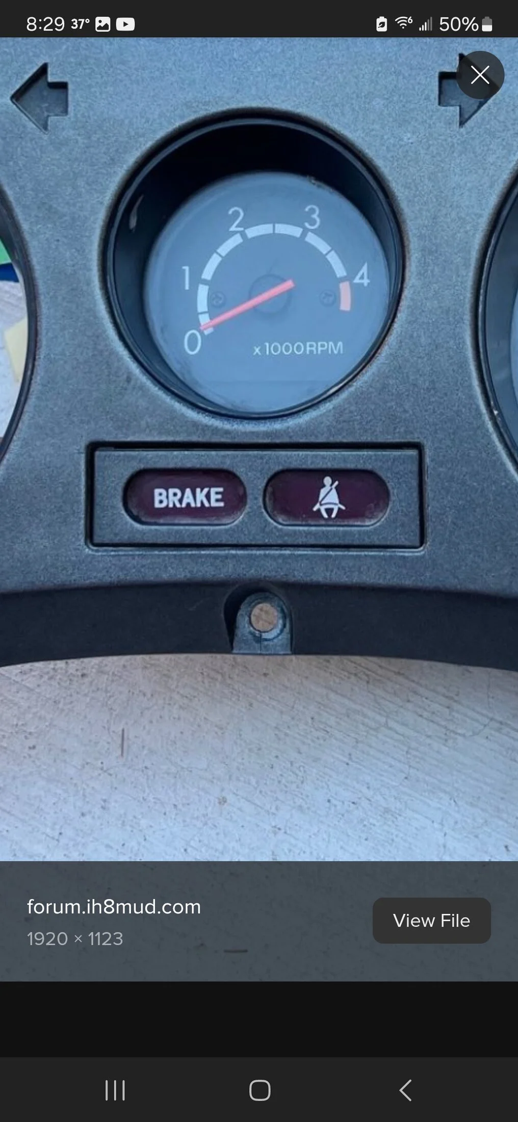

The seatbelt light is beside the park brake light. On the diagram for it, the park brake light gets power(black/yellow) from a fuse and grounds through the switch at the park brake lever. My harness matches this diagram.

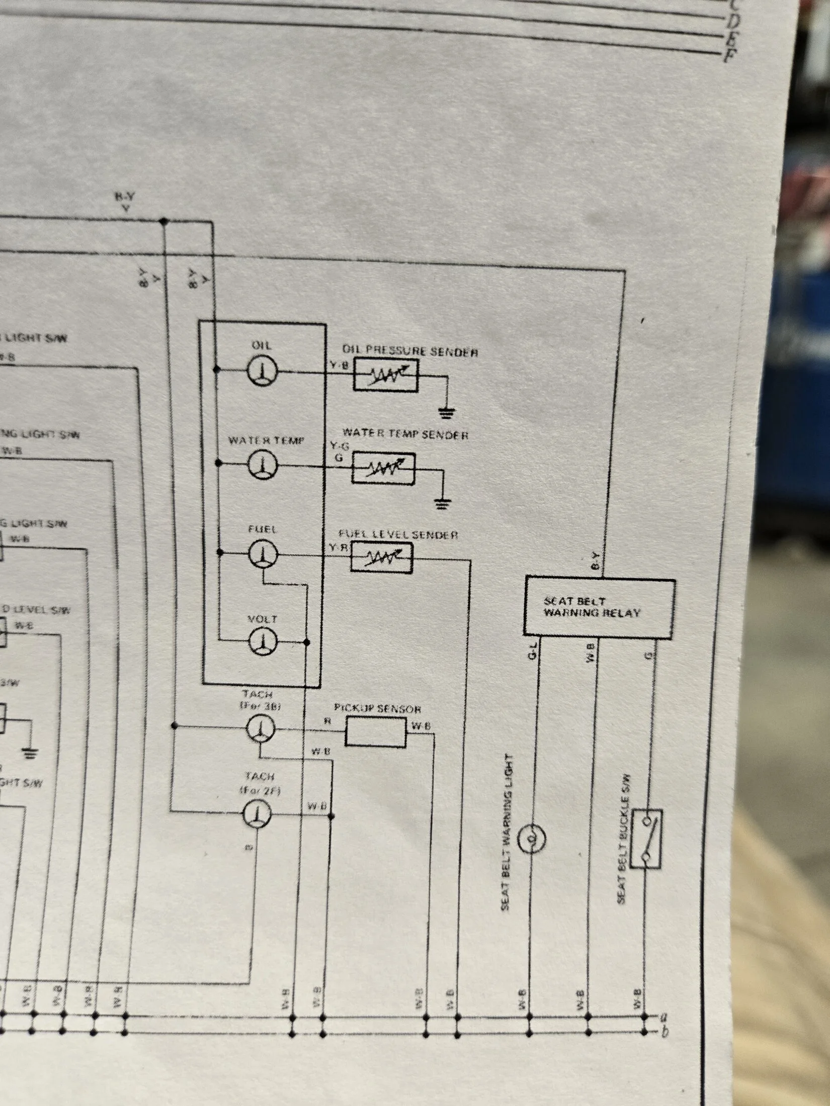

Now, for the seat belt light, the diagram I have shows the light being powered by a "seat belt warning relay". With the switch operating that relay. The bottom wire from the bulb in this diagram would be ground(wht/blk)

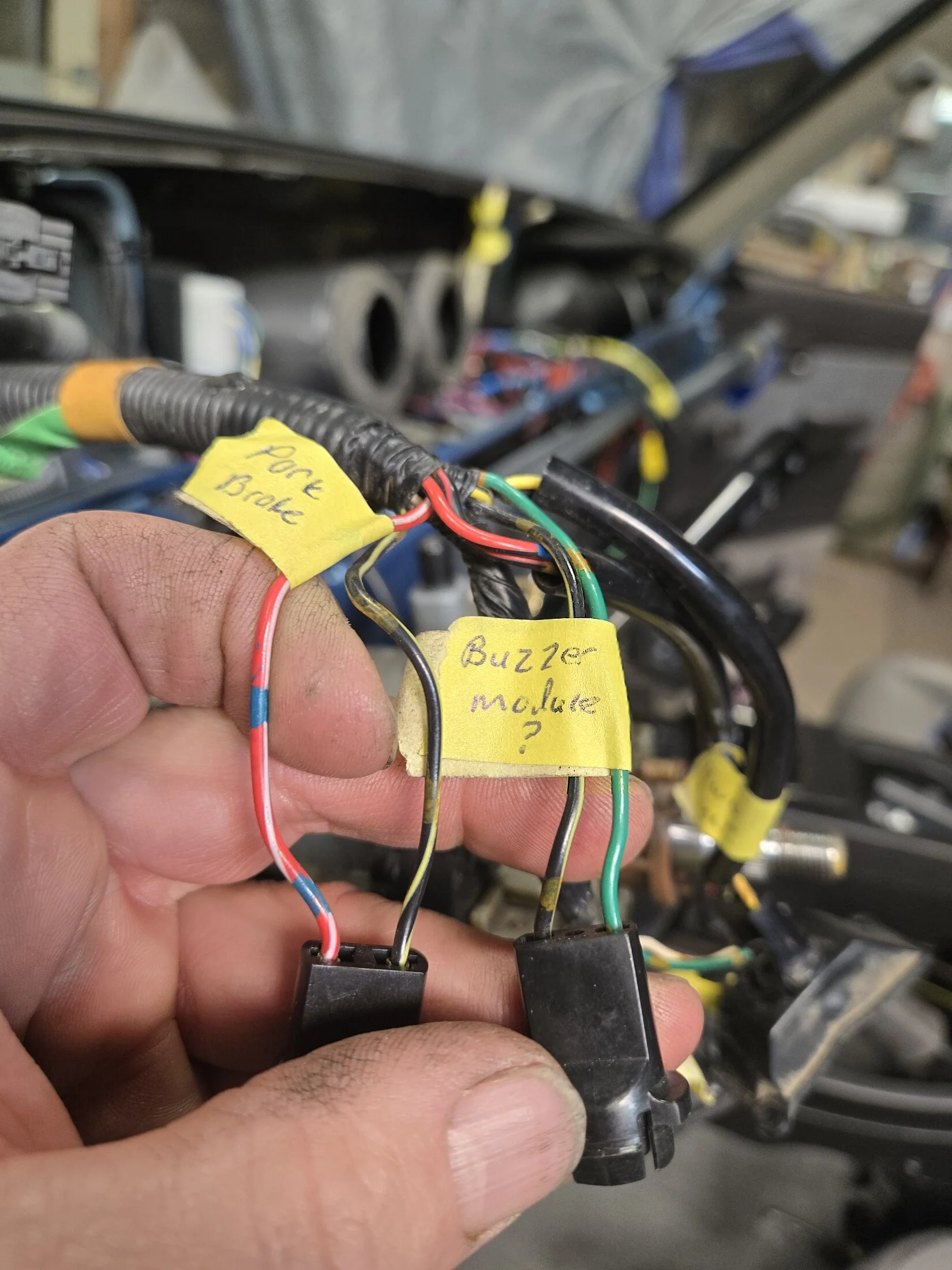

Problem is, that's not how my bulb is wired. Wire colors don't match.
You can see in the picture the two bulb sockets. Each has a black/yellow wire that supplies power. The green wire i have labeled buzzer module goes to the warning relay was.

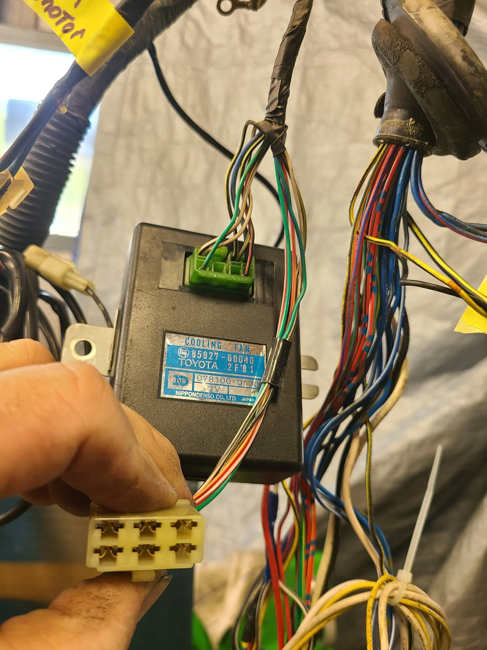

Why the difference from the diagram? It's just 1 year model different, and i do have that relay. I have the relay, but it's not connected to my harness(it has 6 pin connector). Where was it located? I looked through my old pictures and don't see it. Maybe this was where it was by the cooling fan relay. I believe that was in the right kick panel? Correct?(I deleted the fan relay, btw)
All I will need to do is ground that green wire from the light, but a proper diagram would help me find the other end of the wires and be more comfortable.
