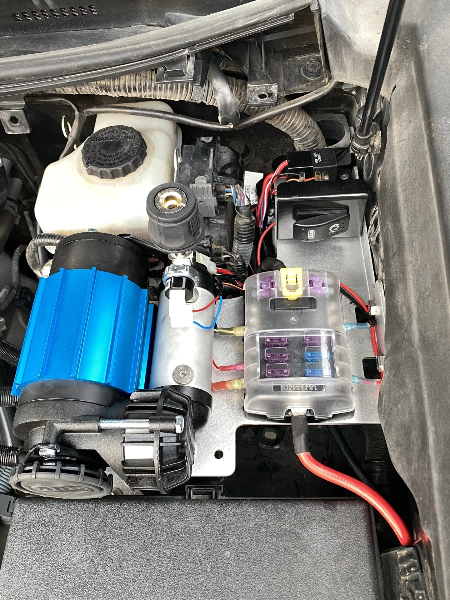

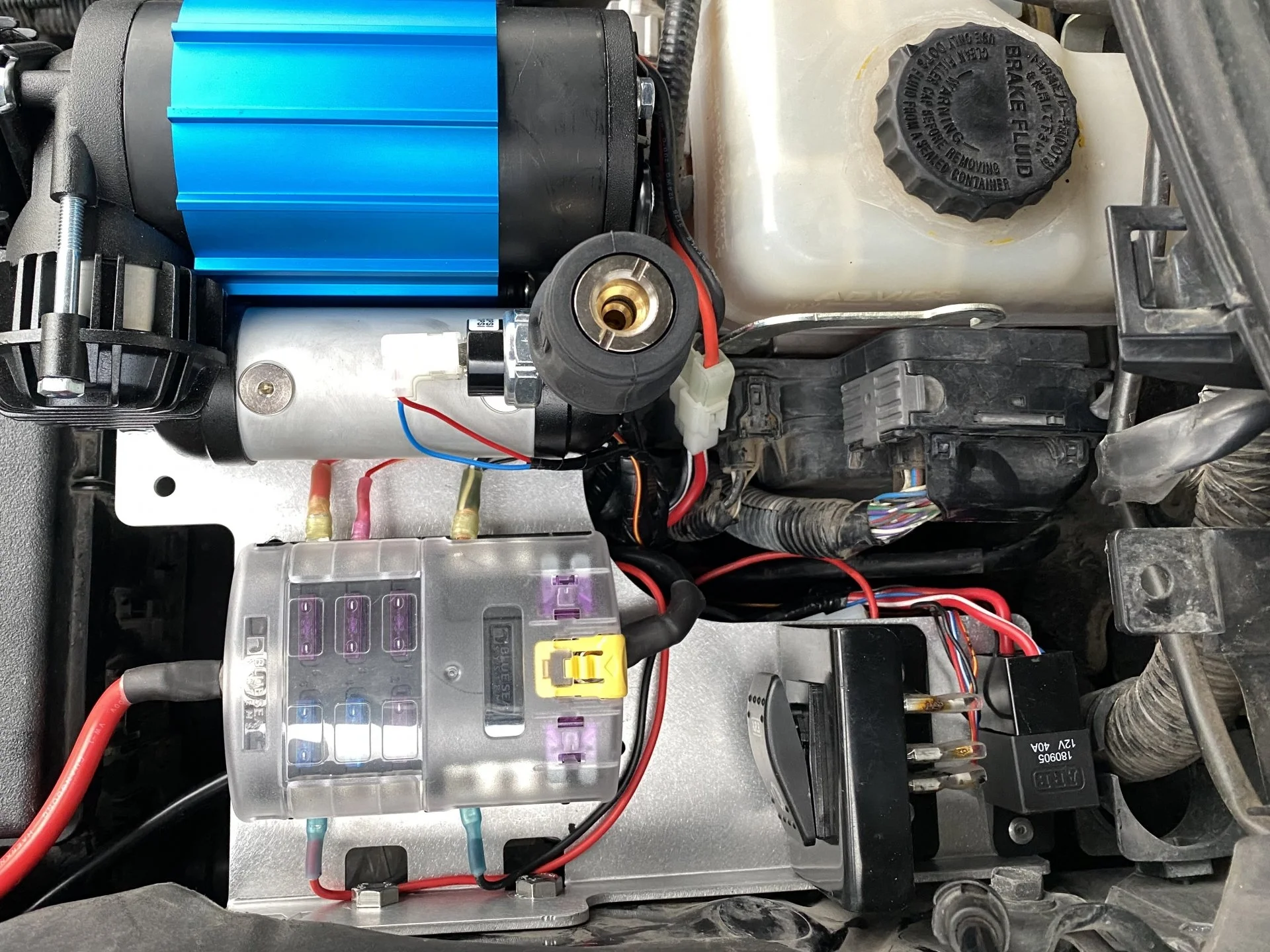

Here’s how mine looks with everything contained under the hood. I just realized you said you have the twin, so the main power plug is bigger than mine, but the rest should be the same.
I didn’t hack into any factory wiring, since that’s one of your concerns, just tapped power and the rest is all in the harness that comes with it.
