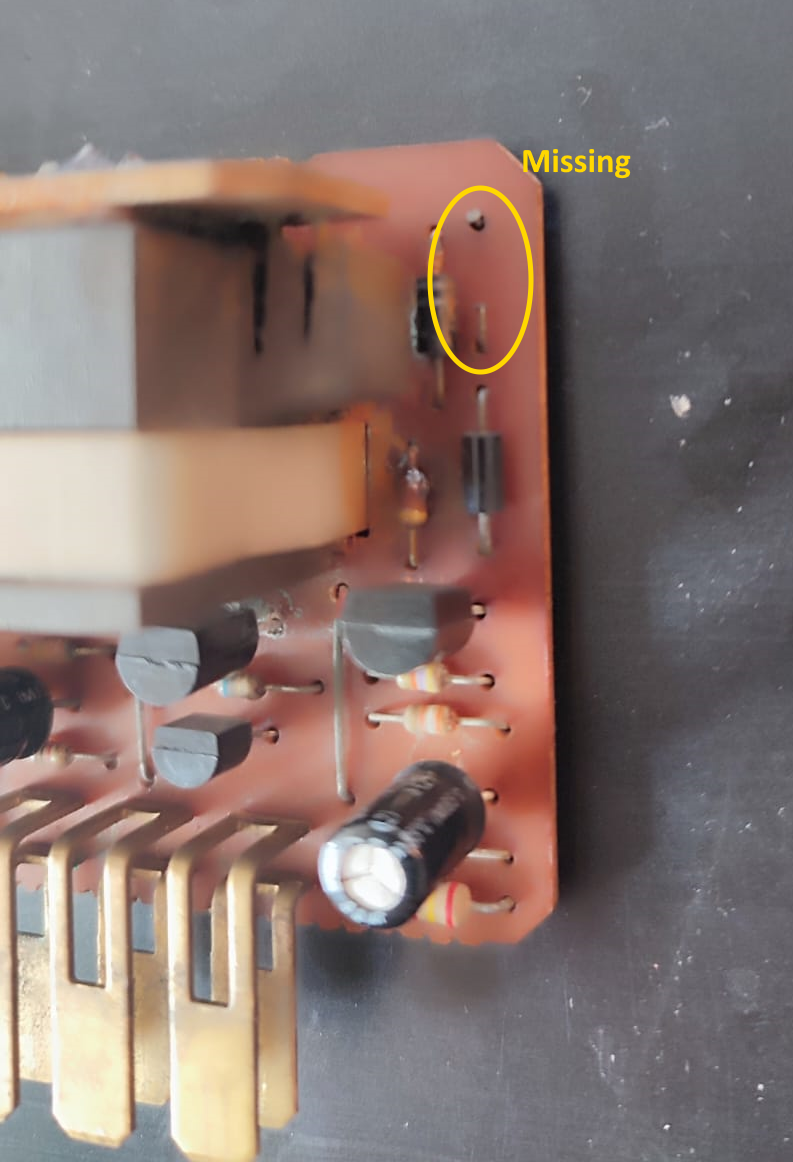

Hi Guys,
I want to repair my wiper relay circuit board after it got water damage. Does anyone now if there is a scheme or something? On the picture you can see there is a resistor aor diode missing. Any help is welcome.
Maybe someone have a good picture of a good one from the inside?

I know, thats why i want to repair them. its pretty basic circruit board so must be easy. A scheme would help, or atleast a picture from the inside so i know what should be on the position of the broken component.

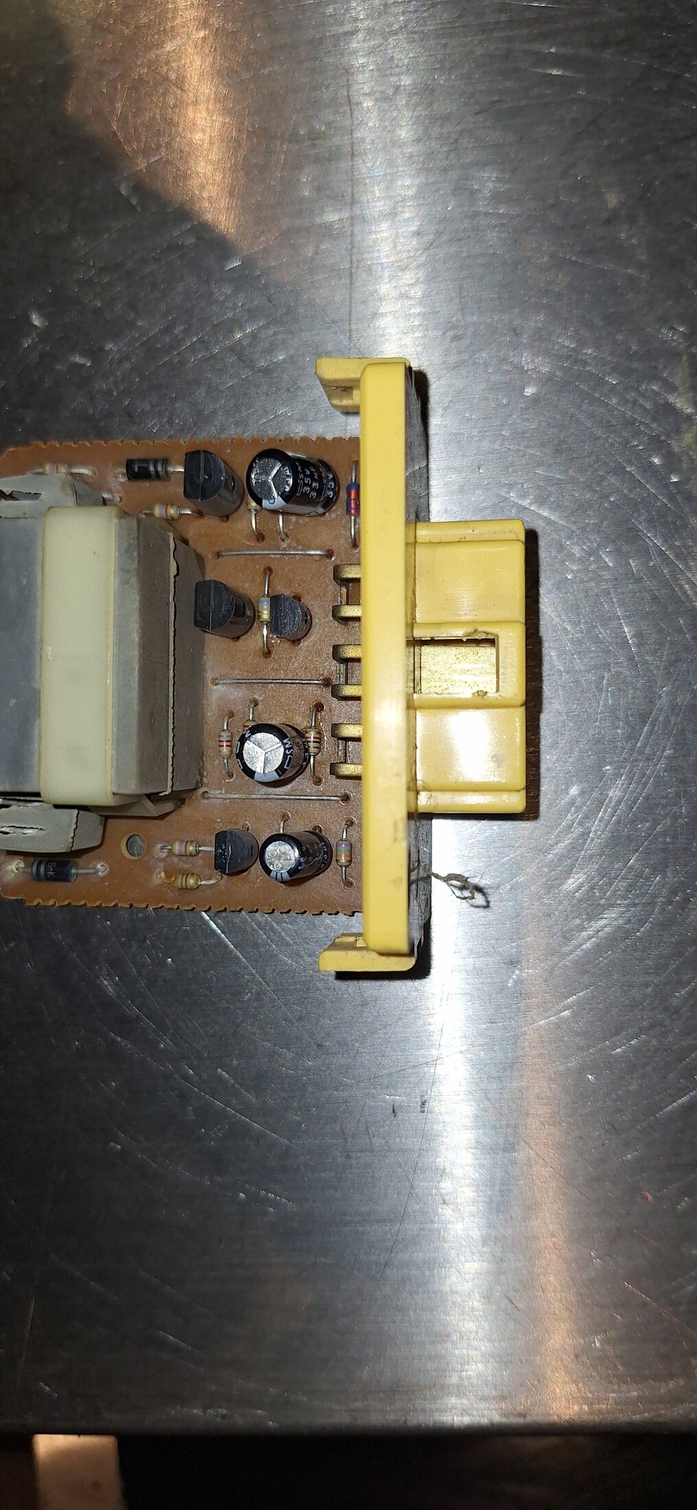

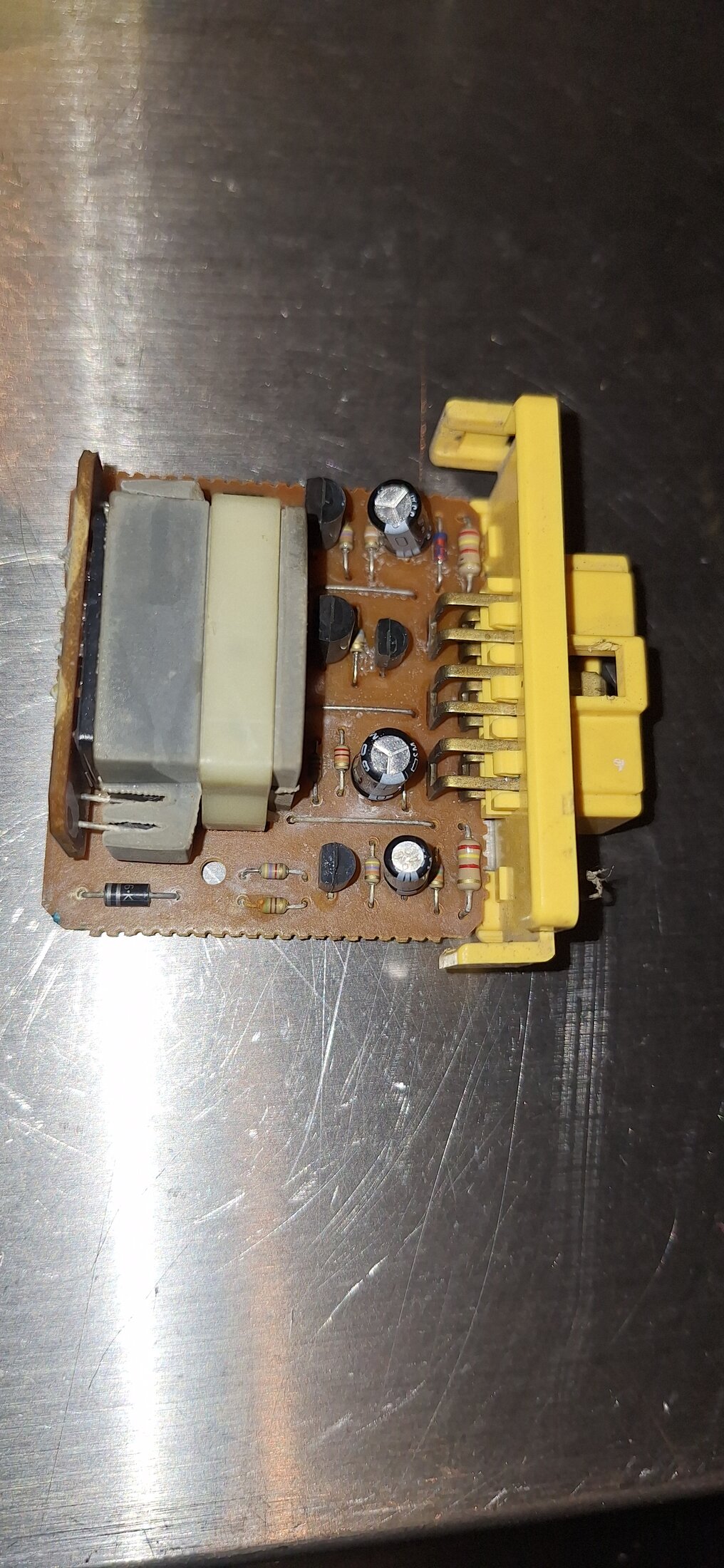

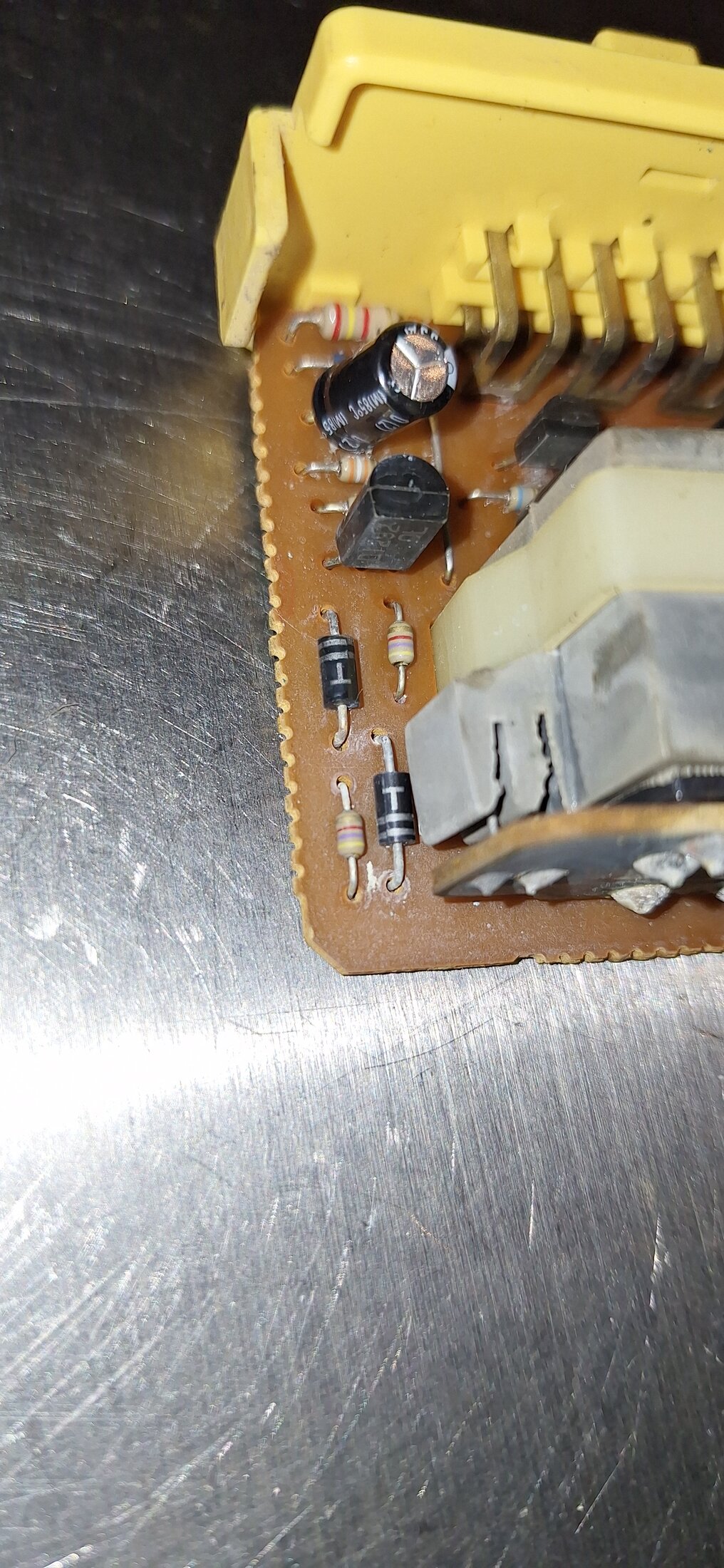

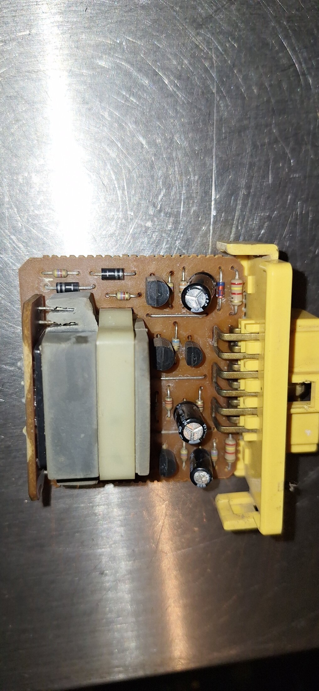

When installed, where is this thing in the truck?
Hey Sequenszer
My relay is on top of the stove drying out after filling with water. It is complete. no missing components.
I have to go out now to pick wife up from station. 4 hour round trip.
will take photos tomorrow morning before I reassemble and refit.
cheers
Dan
