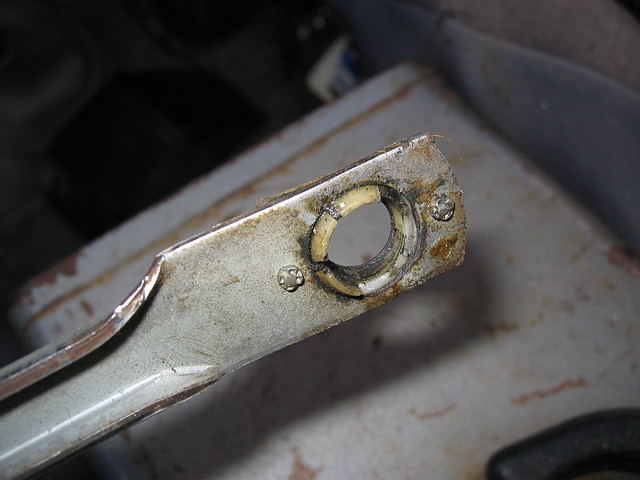

I busted a few of the little plastic hoo-hickeys off the wiper linkage end where it attaches to the wiper motor.
This linkage:
These doo-hickeys:
Has anyone come up with a way to replace the plastic part? Is this piece still available from the dealer or is the only option to find a used replacement part?

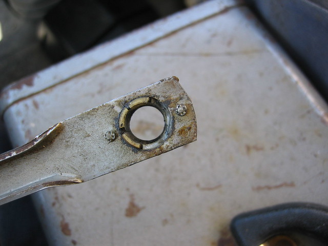

I don't know of any replacement parts. This is what I have out of a 79. Shoot me a PM if you don't find replacement parts. I pulled this in 1993, so it has been laying around unused for a few years. It looks OK.. but you never know with used parts. It still has grease on it and articulates good.

Your local auto parts house should have them. Dorman makes them in their "HELP" line as wiper bushings I know my local Oreilly has them but not sure the size.
We tried a bunch of different options at my local auto parts store, but nothing was even close. Turns out, I found a spare linkage from a 40 I parted out years ago, so problem solved....for now. It seemed like there were several people who PMed me with linkages they were willing to give/sell me.....might be worth posting up an ad in the "Wanted" section.....
