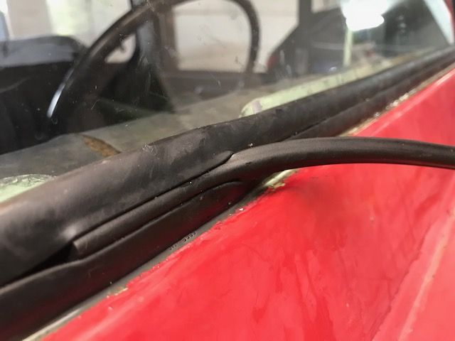

It took about an hour to replace the windshield in my 1970 FJ40. The "rope trick" worked great! However, trying to get the weatherstrip locking strip in is another story. At the rate I'm going with a screw driver and windex, it should take about four hours! I'm sure there must be a proper way or tool to use to facilitate this and would appreciate any help!
Thanks!

Hi, Google. There is a simple ,cheap tool to install chrome and black strips.Lisle makes several different types. This is old school. Mike
