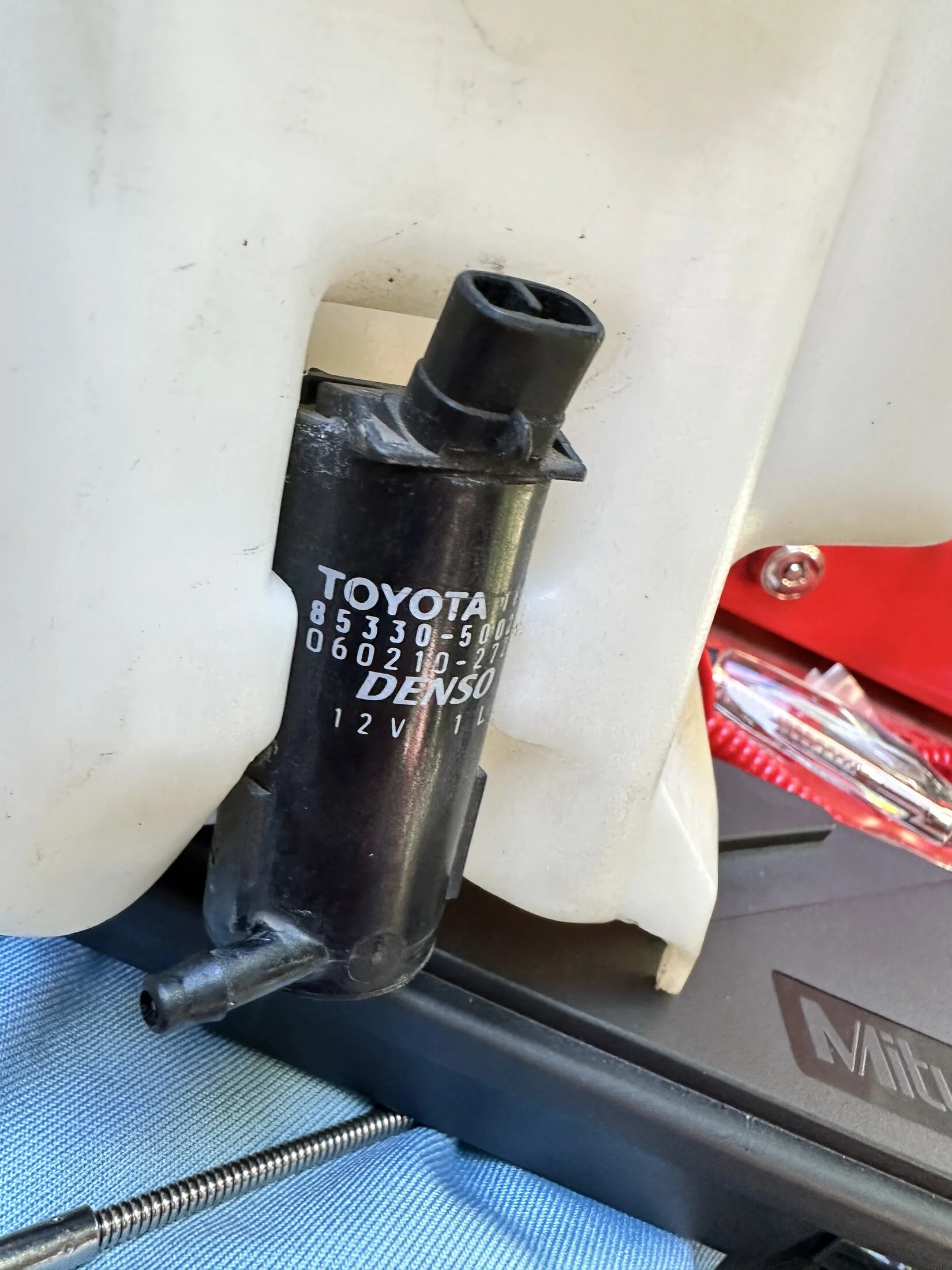

My Land Cruiser (FJ62) is missing the electrical socket that plugs into the washer pump. Someone just put the raw connectors onto the pins. I’m not sure if this is the OEM pump, here is a photo:
Does anyone know where I can get the plug and correct crimp on socket pins for the connector?
That's a 4Runner/80 Series pump, should be easy to find a connector at a scrap yard.

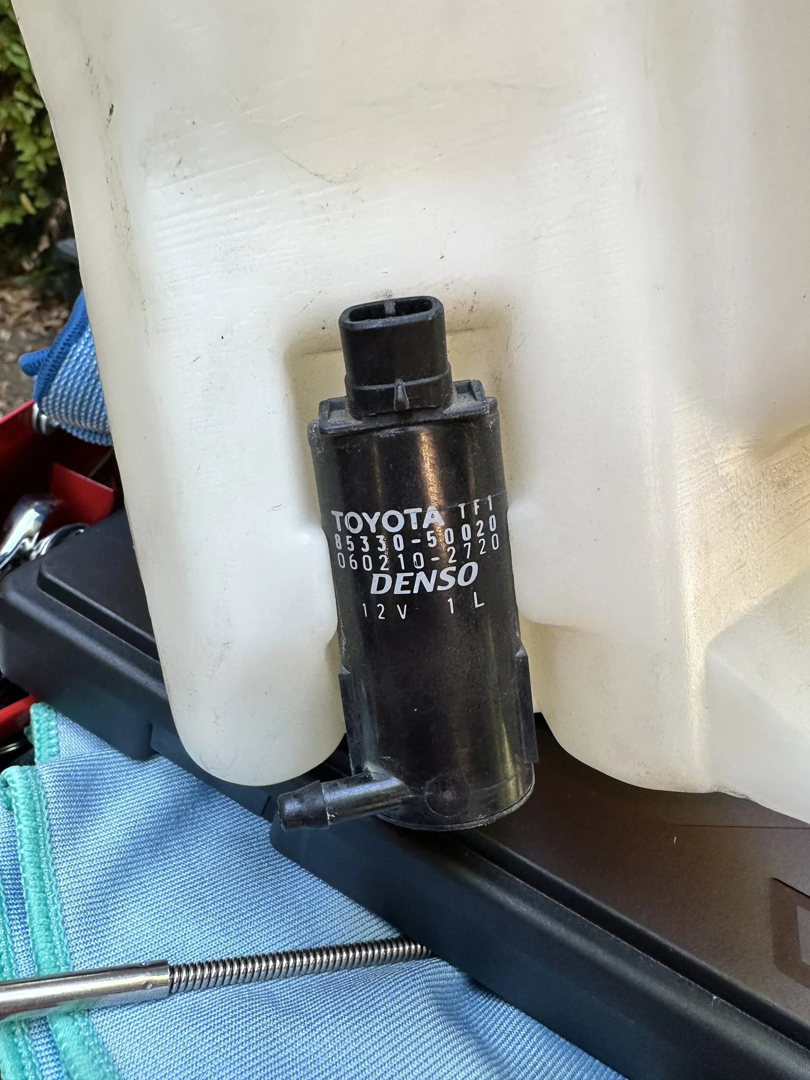

The easiest solution for you might be just a new 60s-series washer kit from Cruiser Corps. They're in stock. Just got one.
