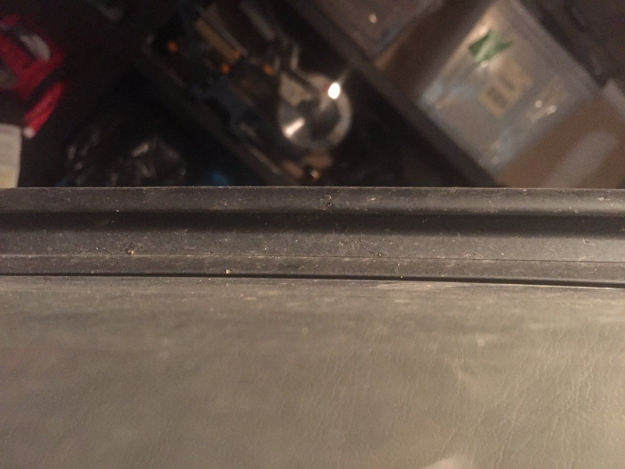

What gap are you referencing? The a-pillar molding on the windshield should fit snug down to the glass, but it does have a gap so that the rivets can be accessed. This is what it should look like:

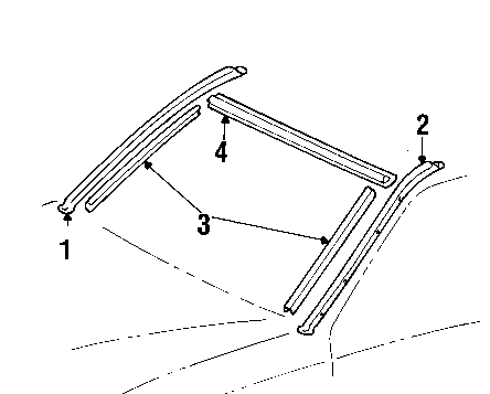

Found this image on internet, I believe I am missing piece no 3. Based on what you said, there should be a piece that is covering the rivets. On mine, I can see the rivets.

Yeah, that looks like the piece that rides in the channel of the big molding, and covers the rivets.
