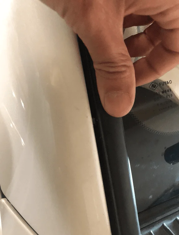

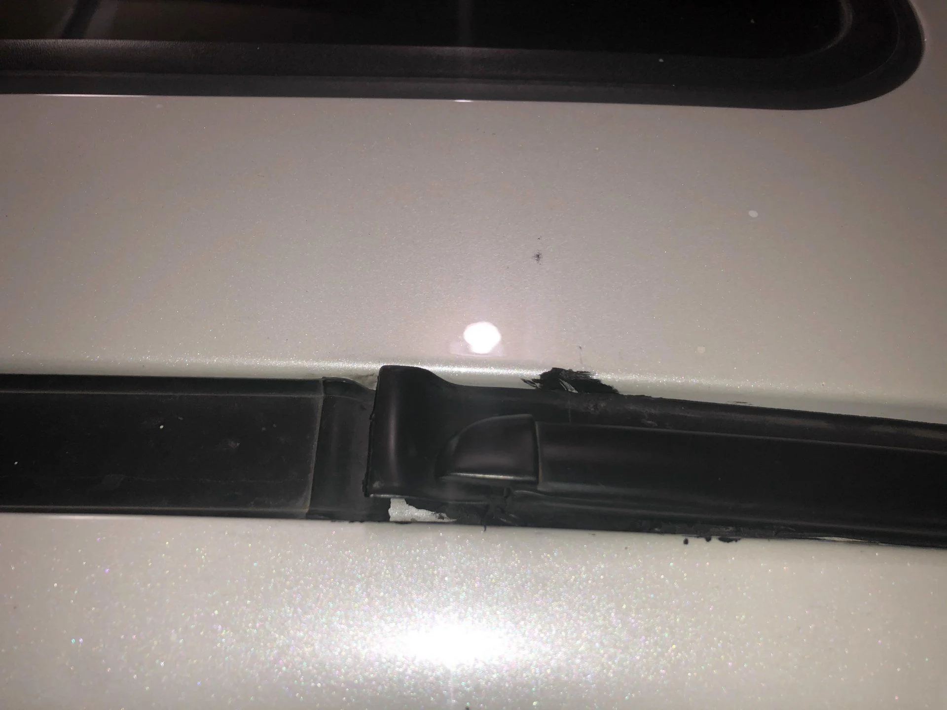

Hi,

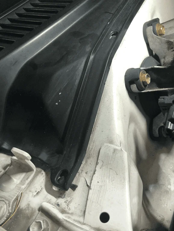

This maybe something small.... The trim of windshield on my passenger side is popping up. What should be the best way to deal with it. Replace? Glue? Or Leave it as is?
The windshield was replaced 3 year ago at an LX dealer under previous ownership. I believe replacement would be ideal. But I saw one video on YouTube that to secure the trim into the pillar frame seems driving nail into the frame. I am not sure if those are pre drilled hole on the frame or it has to be new holes to be created every time a new trim is installed. I also think there is a possibility that the previous installation of windshield does not 100% follow the FSM or something went wrong.
Any input is appreciated.

The last install probably reused those moldings, pretty common for them to be jacked when that happens. It’s possible to make a mess of you yank the moldings back and try to ‘fix’. If it were mine I’d leave it alone until you need a windshield, or I’d pull the side cover on an a-pillar (outside car) and see if you have rivets or screws.

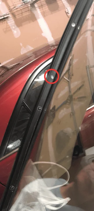

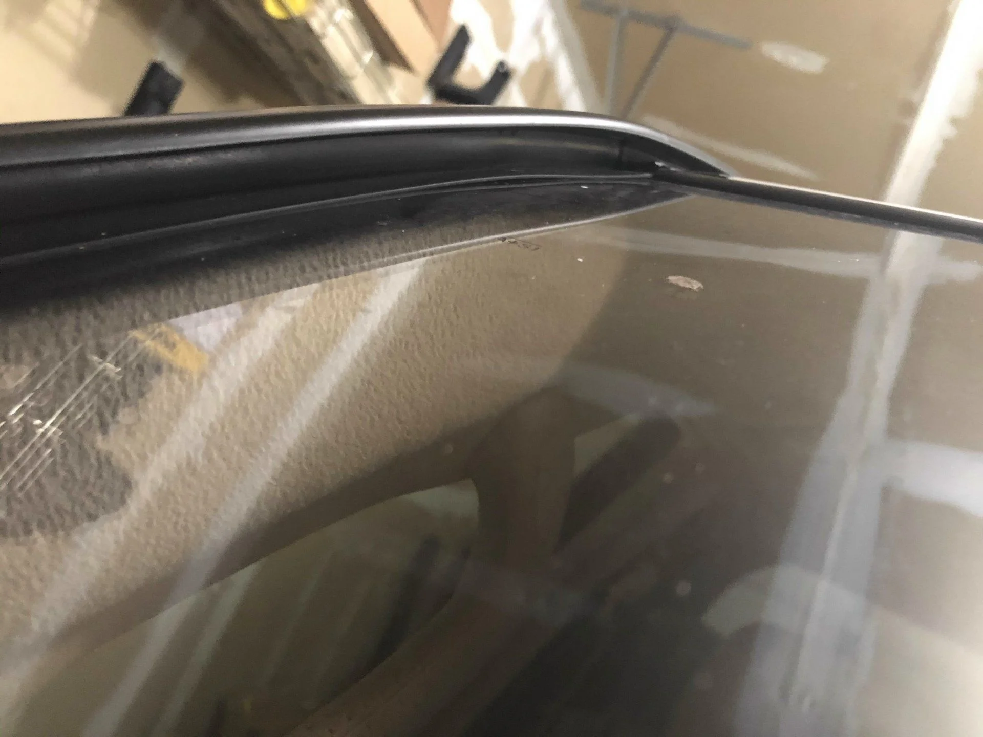

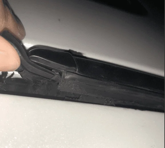

Well. I was able to take a look at the molding again. Then I found out play of the molding at the lower end at the passenger side. Opened the covered trim then found out the molding was secured by 4 rivet and 1 screw. and the molding is loosening at the lower end (photo attached). And the upper molding has a lot of black silicone glue stuff. After reading through LC2001's thread on windshield rust. Would assume the molding need to be replaced and the screw need to be removed to prevent rust? Was the the hole of the screw drilled by the windshield installer? The A pillar has no rust at all and the molding seems function now.
The last picture showing the trim piece. I think they put a aftermarket trim, but tried to use the old clip, and those clip head was about the size of the hole. Not saying half of the old clips were broke.
