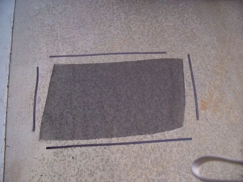

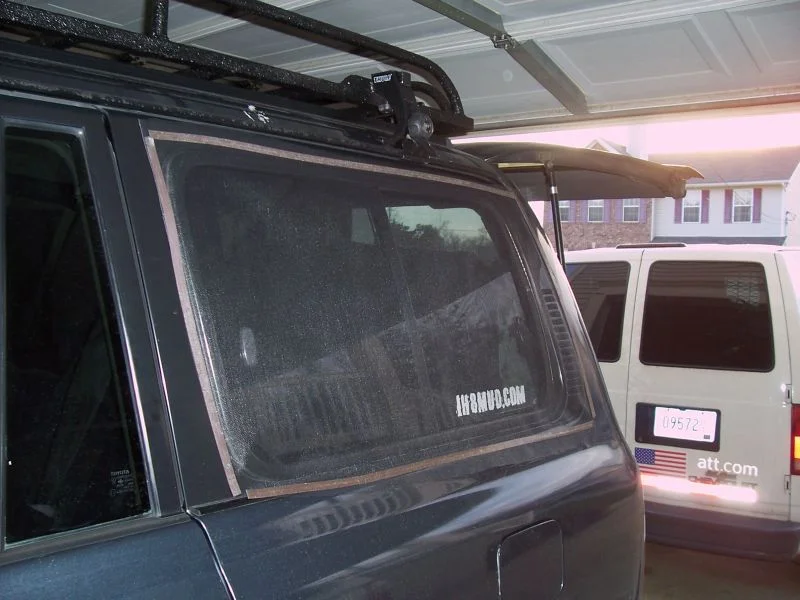

I had a couple request to show what I have used for window screens, we made these for our summer camping trips, when we sleep in the cruiser. I used window screen material available at any home store, and it has worked very well. I think you could also use no-see-um netting if you are going to be somewhere with very small pest like black flies. To attach we used magnetic strips cut to appropriate lengths.

That's pretty slick!
When I bought several years ago the Sleeper from this people XO-Shell & Omni-Shell details (by SAFARI SOFTSHELL, INC.) it included the magnetic holded nets for the 4 doors and the 2 third row sliding windows.
They were professional made with waterproof fabric enclosing the magnets and sewed all around the border of the net, but yours works exactly the same and I bet it cost you a lot less of what I paid for mine.
Anyhow, I must recommend your idea, it's the best to keep away the bugs from the cruiser and letting the air get inside.
