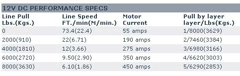

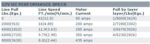

Well If you don't want to wait and buy an 8274 as Poser suggested, then I'd still at least buy a Warn winch, just a less expensive model. I had an MX8000 (the predecessor to the M8000) on my 40 for twelve years and used it dozens of times without a problem. As Toyo40 mentioned, you can get an M8000 at Winchdepot.com for a good price. Some specs for the 8274 (first) and M8000 (second) show that the line pull under 4000lb loads or greater are comparable:
