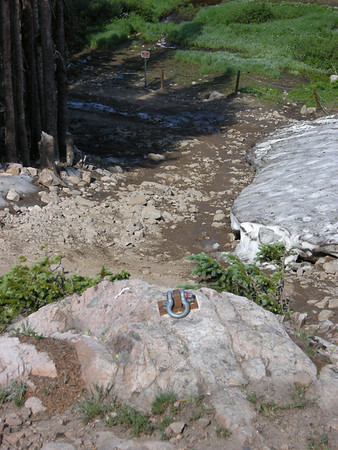

There are a couple tough trails that I know of here in Colorado that have permanent winch anchors attached to the rocks. These were installed by the local land management agency (with my club's help on one of them). If you're traveling a well-used trail and you feel the need for a winch anchor at a certain location you can bring it up to them and maybe they would agree to install one.
I have seen permanent anchors on some of the old back country roads here in the SW. Usually to get over a "waterfall" in a gravel wash. It's fairly common to see the washes scrubbed down to bedrock with no trees or boulders large enough to winch off of.
What kind of gangster welding are you doing there...
Wasn't me, but a guy in the club burned up one or two Optimas running a Mobi-welder on that setup...
