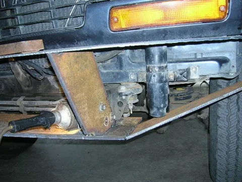

Here are a couple more "mid-build" shots:
And one more...
Are you going to relocate the AC drier?
I managed to move mine up about an inch by changing the bracket and re-shaping the lines, just enough to tuck it inside the box on the wing. You can see in your picture from the driver side that if you moved it up you would have a line from the frame horn to a reasonable spot on the wing. Of course that would mean more plate and more weight.
No, it's staying put. There is a gusset which runs under the drier from the frame rail to the front of the bumper, protecting it.
Sorry... I was not paying attention, I see it in the earlier pics, looks good.
