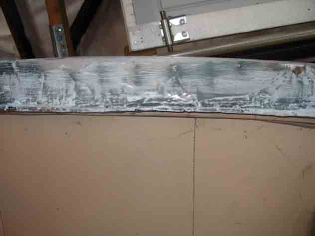

ok been busy on wilma this past week. i welded in some new matel in the top of the door ffrrame ont he passenger side. of course all I have is a beffore and after shot and nothing during but here they are non e the less

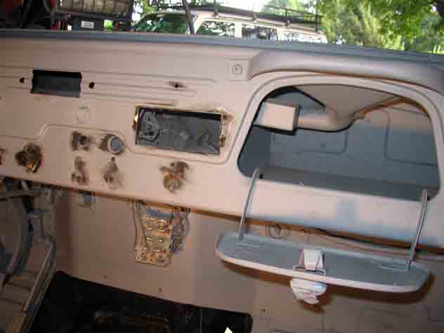

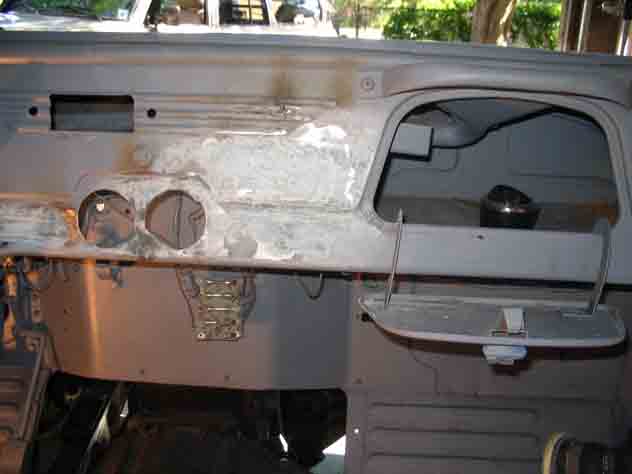

Butt most of theis week was spent on getting the dash all worked out. i had removed a bunch of buttons and things and am going to start from scratch. so i weled sot all the little fuse holder thingys and everything else and figure to start form scatch on all the new stuff. I did order son AC vents so i could fit them in now . I went with the billet vents that I picked up from Summit racing. thay had so all machined ones but I went with eth eones that have black vents in that the all pokished ones were a bit to bling for me. i cut the holes for the AC vents in so i could weld up everything else. still waiting on the mail for the section to patchup the hole left by the stereo. but i have sealed up the ashtray and the kighter hole L(

did a couple more coats of fill and senaded it off to get the dash smooth. it is getting better

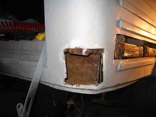

i decide to tear into the rear quarter panel that is bad. I cut out a nice square to patch in new metal. and found that the whole rearchannel that houses the tail gate hinges was literally packed with dried out mud. so I made the decision to cut some holes down the lenght to clean it out and get a coat of epoxy primer in the inside of the cannel.. oh well got to make it right:)

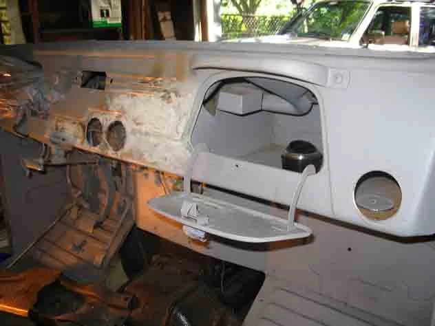

earlier this week i finished up the dash so far just waiting on the dash piece for the stereo hole....
i next started the rear passenger quarter panel repair. basically the rib second from the bottome had rot all along its lenght as well as the rear corner. i started off y cutting out the rust and cleaning out the mud then getting it cleaned up and primed. then i had gotten a chunk of a lv being parted out unfortunaely when I got in on the part out someone had already claimed the fender son I only got half of the rear quarter ribbing. i i ended up using two of the ribs and welded them together in the middle. the more i do the body work the less you will be able to tell they're were 2 peices.
and
then i started on the rear corner. I decided to weld a curved peice inside and then weld on another curved peice on top of it give it that extra stiffness for the corner. maybe thats a bad idea we will see how it shapes out.
