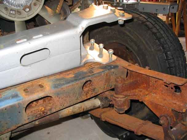

I have some engine work to do and i have a custom built front crossmember that i got from fox fab, i forget who makes them, that i will mount a saginaw box too and it will run off of the stock 87 2f ps pump. thats the plan anyway. still not sure of the lift but thats a ways away anyway..

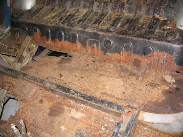

my camera is really good at making rust look much worse than it is. butI still have my work cut out for me.
Dumb question for someone here, but what made these things rust more than a 45lwb or a 40 from the same year ? Is it because they put carpet or something in to hold the water ?
Just wondering.
I think thats got to be the case with mine. while the floors are simply horrific everything else is in decent shape. the fenders are mint and I only have one exterior body rust issue.
you can kind of see by these pictures how the floor must have been wet and how the rust creeped up the sides a bit..
jp
The roof is braced with a square channel for support around the entire edge. Any and all water that collected in the rain gutter(one a small hole formed) would run directly into that channel. From there I believe it runs down the B pillars into the floor pan. There are four drian holes but they usually get blocked or still have the factiry plugs in them. Another possibility is the hinges are supposed to have gaskets but all the LVs I have seen are missing them. That also allows water into the floor area through the cowl and B pillars.

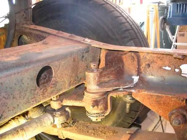

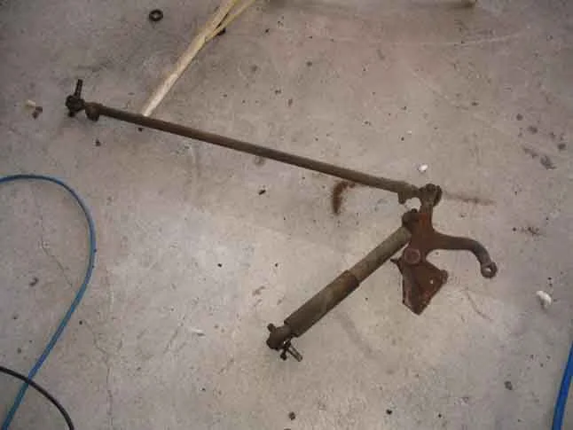

i got all the stocke steering components off without hrting any of them. i will be putting a saginaw setup in so i will not have any need for the stock stuff.
I got a nice packagge of steering parts off ebay but that box is still at Fox's so I'm not sure what else i will need but the ebay collection has a late 70's steering colum and all the shafts to conect it to the saginaw box.
Instead of the typical scab mounting plate for the saginaw box i will be replacing the whole front cross member the last 3 shots show the new bracing which will also box in the whole front end of the frame.

If you don't need that crossmember, can you save it for me? I am going to patch this hole in the LV. I could use some of the stock steering parts as well if you don't need 'em.
