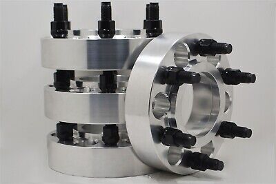

Would not fit as is.
Hub bore are 95 mm instead of 106.
Offset is 55 or 45mm. Stock GX470 is +25. It woukd rub the suspension.
There is adapter you could buy and they are expensive.
