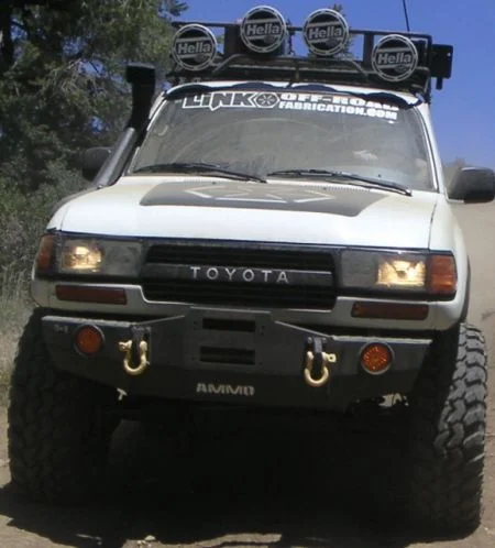

Pablo, I ran tires that large with just the OME 850/863 springs but included 2" spring spacers in the rear and 2.5" spring spacers in the front. It was an affordable test of whether I really wanted tires that size and worked out pretty well. I rode that setup for nearly a year. You'll want to make sure the shocks you have can deal with the extra length but it's not a big deal. They will fit the stock alloys fine.
Another way to deal with it versus going with big springs is to do a 2" body lift and you can run those springs with 37's (this is what AMMO did).

37's 3" heavy OME and a 2" body is more then enough to clear 37's
