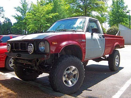

I ran 33x10.50 Swampers on Tacoma rims back when I was driving an 81 pickup. These worked out really well, and made the truck look great.

I added a picture of it for you non-believers. I think these were a 15x6.5" rim from Toyota.

Dude, those are the 7" wheels, pretty much all the alloy versions from '84 onward are 7" and made for a 10.50 tire. Older model steel wheels are 6", but latter model 92-95 and tacoma steel wheels are 7". Also the taller the tire the less you need to worry about say a 12.50 tire on a 7" wheel. I ran a 31x12.50 on a 7" wheel, a 32x12.50 and a 33x12.50. The 33" tire has the least amount of tread crowning and the sidewalls seem to flex near the proper areas. On the 31" tires, the sidewalls didn't look to bludge in the proper area but worked fine. This mostly translates into heat buildup.
My buddy used 35x12.50s on the 7" alloy rims. They worked OK. They were a little round, but if you ran like 20-22 psi street preasure they flattened out allright.
