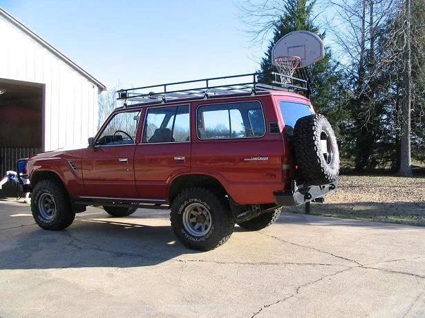

Just like the title says.......Ashley Installed the new header on my 60 & also had a great idea during the install to line it up!:idea:
Background: previous header was warped beyond repair.....I removed & purchased a new one.....4 months later:rolleyes: ready to move in a couple of weeks to TN & rig has to drive:eek:
Yesterday I started to reinstall the heaeder & found when tightening the 4/5 exhaust bolts it would cause the flange to allow for a gap.....:mad: ......decided to lay tools down & think. Today I decided to try again with the wifes help, she loosened all the bolts & while I pryed the heaeder from below towards the drivers tire making it flush with the flange.....success;) .....not for long....as soon as she tightened the bolts there was a gap:mad:
Ashley being a quick thinker said" hook a rachet strap & pull it towards the left front tire & I'll tighten er up"...........hell why not nothing else has worked.
:bounce: Away we go rachet strap tight & Ashley wrenching away.............it worked!:bounce2:
Just goes to prove a wrenching cruiser wife comes in handy.............now for me to pay her back for the service performed:lol: :grinpimp: :D
Few pictures from todays wrenching session:princess:

Well its rollin.........
Cut the collector off the off the exhaust pipe & welded it:D
From there I tinkered with a few other things & wall-la runnin.....still with a nice lope:cool:
