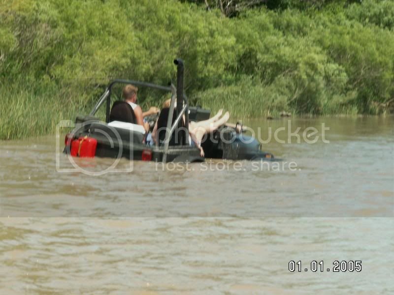

What is "that" called? Everyone fills their cooler, gets together at the local river, and drives down it? Back home, we use boats for such occaions ;p Quite the sight, I've never seen so many rigs in the water like that, I'm sure its a blast though!
I was looking at the pictures and scratching my head. What the hell? Driving down the river drinking beer with 20 other rigs? Where do you live?
Ewheeler is right, I would rather do that in a raft or a boat.
Well I'm not from Nebraska nor do I live there but I get what they are doing and it looks cool to me.I have almost identical pics of a guy getting stuck in a river crossing half a world away. Here are some shots from my local club's last get together with five clubs from Guatemala.
John
About the river, we do not have any trails close and the water is a challenge. Most of the time we are to the rockers with water on rigs with 35's. The river bottom changes every week and makes it a "new trail" with soft spots and holes moving all the time.
And for the Environmentalists, we take more trash home then we bring to the river. We are like the guys in the orange suits on the side of the HWY, cleaning as we go:steer:

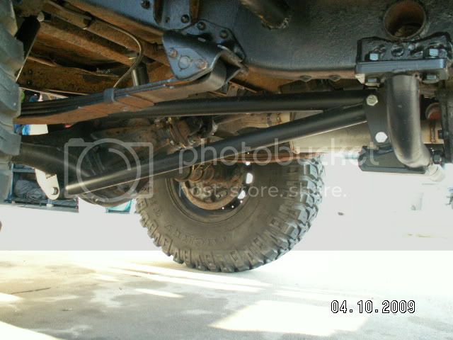

Also added a torque arm, works great!
