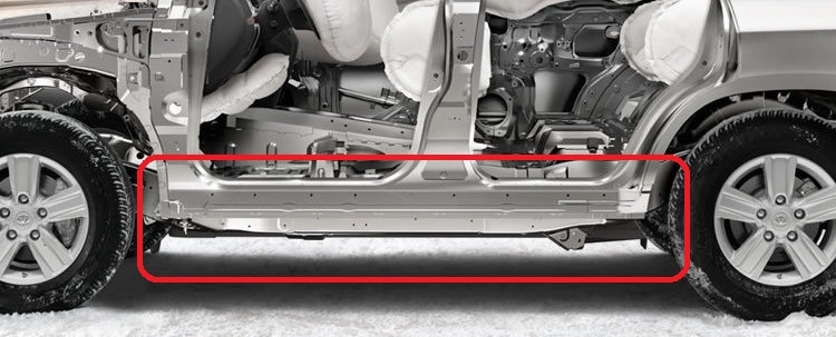

It's the section of the body below the doors. Normally, they are steel, and completely part of the body structure. In the case of the 200 series, there is a rocker panel, but it is hidden under a plastic cover that appears to be the rocker panel.
This picture shows it, sans plastic cover.
