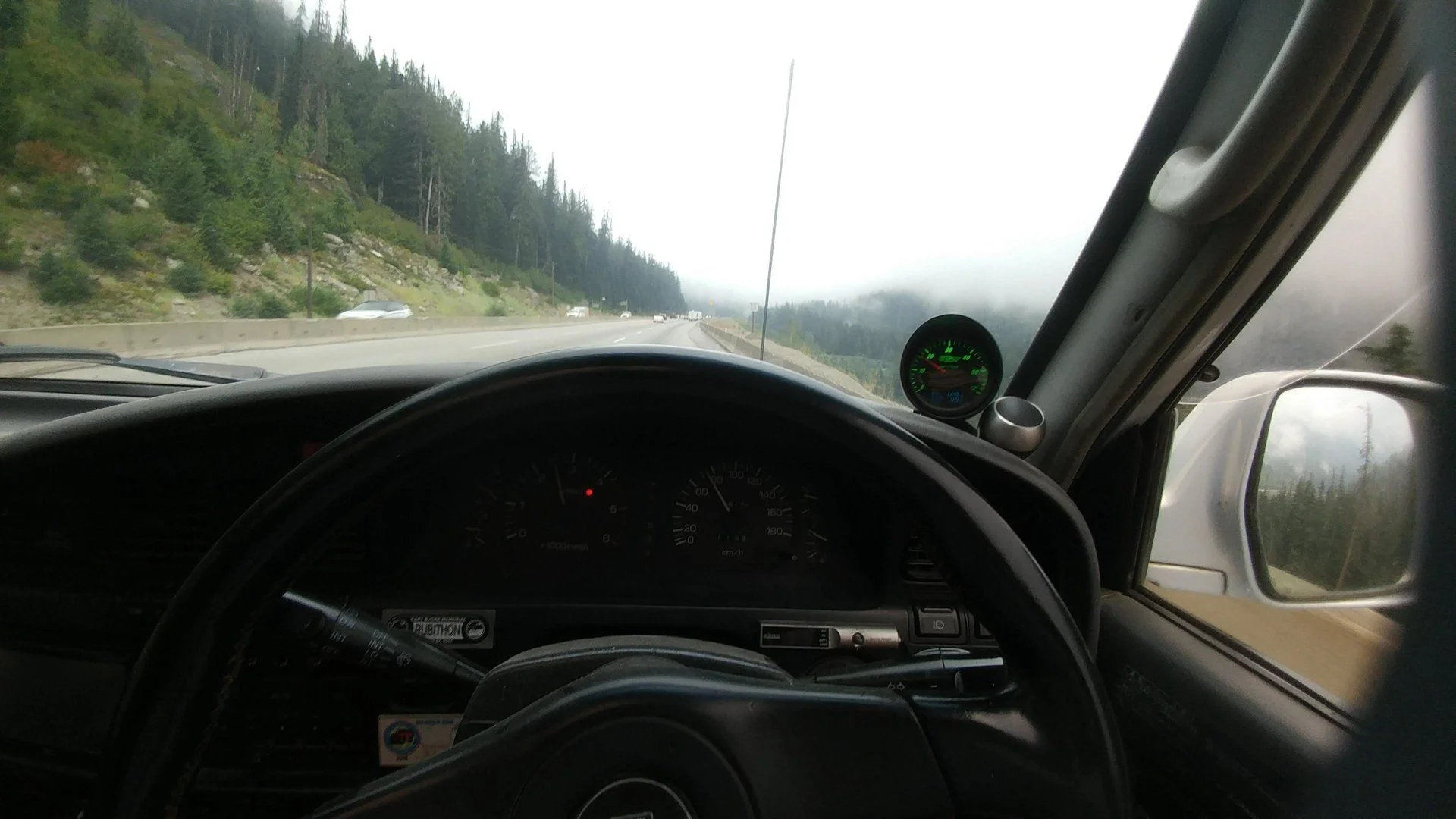

Well we made it up the Coq no prob. We had to stop after the snow shed for construction which caused some concern. Locked in third up the hill at 90 or more kmh with the rpod and the dinghy on the roof. No sign of the Dutch dwarf either. That’s it! @Vanny you will forevermore be known as ‘Double D’!
Ouch, last time I ran that hill was about 20 faster...fully loaded pulling our trailer with the boat on the truck rack :steer:
Oh I could go a lot faster, and I have many times, but that was before I got the stupid gauges to keep me honest.
Which are showing 16 PSI boost, EGT is hard to see but was trying to keep it under 1200, and tranny is at 189 degrees.
