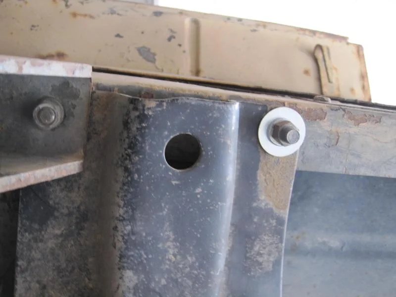

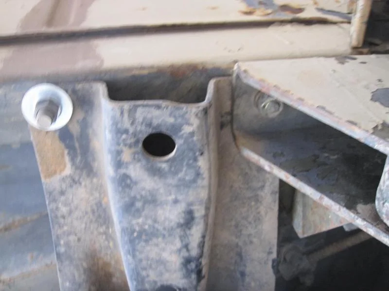

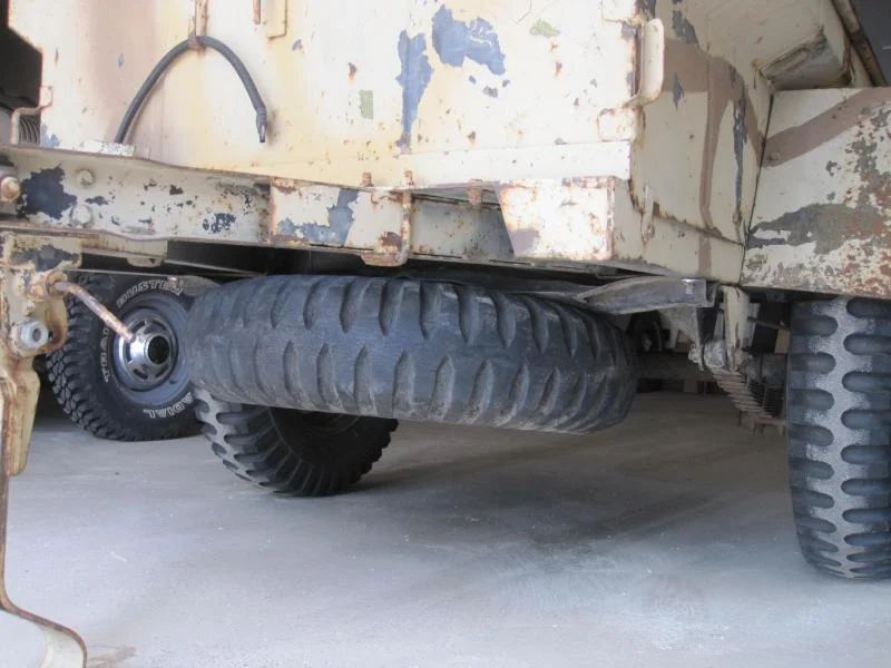

I'm in the same boat as you I use FJ25, FJ40, FJ62 and 100 series to pull my trailers each has it's own spare. I was able to mount a 60 series spare tire carrier to my M416 using two holes on the front spring perches and drilling a new hole in front of that on each side. Works with stock size tires. Any bigger and it wouldn't clear the landing leg when it folded up. My M416 is used quite a bit on the highway and like having a spare along that's not in the way.

$300 is a great price on a 1/4 ton trailer. I had to pay $400 for my M416 and MBT. I also have a M101A1 but the M416 is the only one that I need a spare mounted because it see amny miles behind my 100 series carry larger items to our cabin. I like the 60 series carry because it was simple to install and the jack handles from any of my cruiser will drop spare. Still looking for a place to carry some place to store a lug wrench for the trailer. It would be nice to cut the bracket down and mount it higher but that would make excess to the winch harder and might interfere with the hand brake cable. Decided not to over think it and just go simple. I did use heavy fender washer on the three other bolts on the spring perch to even it out with crossmember from the carrier.

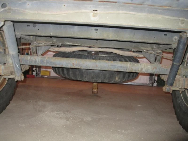

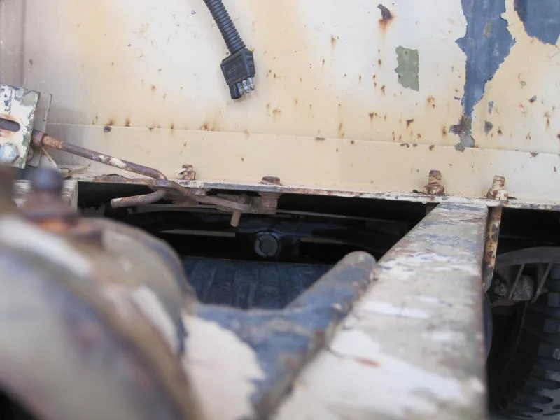

from my trailer build thread (spare carrier bracket from Jeep Grand Wagoneer)
I wanted to mount the spare under the frame, so it hit me this past weekend that I could recycle the spare carrier from my wife's rig, since her 33" BFG's are too big to use the stock spare carrier now. It looked like it was going to work, here's the first mock up. It was too far forward and interfered with the kickstand so it had to be moved towards the axle a few inches.
The "hub" section of the spare carrier is not really doing much, but when I tighten the strap up, the tire gets sandwiched fairly securely up against the diagonal frame members.
Here's how it looks from above in its final mounting spot. It doesn't interfere with the parking brake cables either.

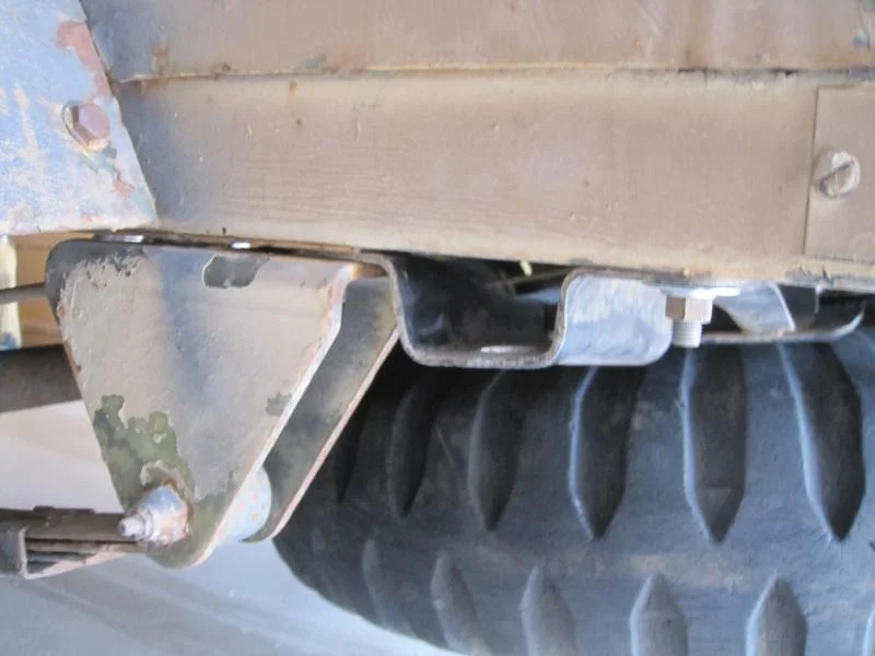

Tightening the bolt on the right draws the strap up.
Here's the other side of the strap that has a double hinge. I simply welded some tube on the underside to accept the linch pinch that is secured with a cotter pin and under tension of a compression spring.
