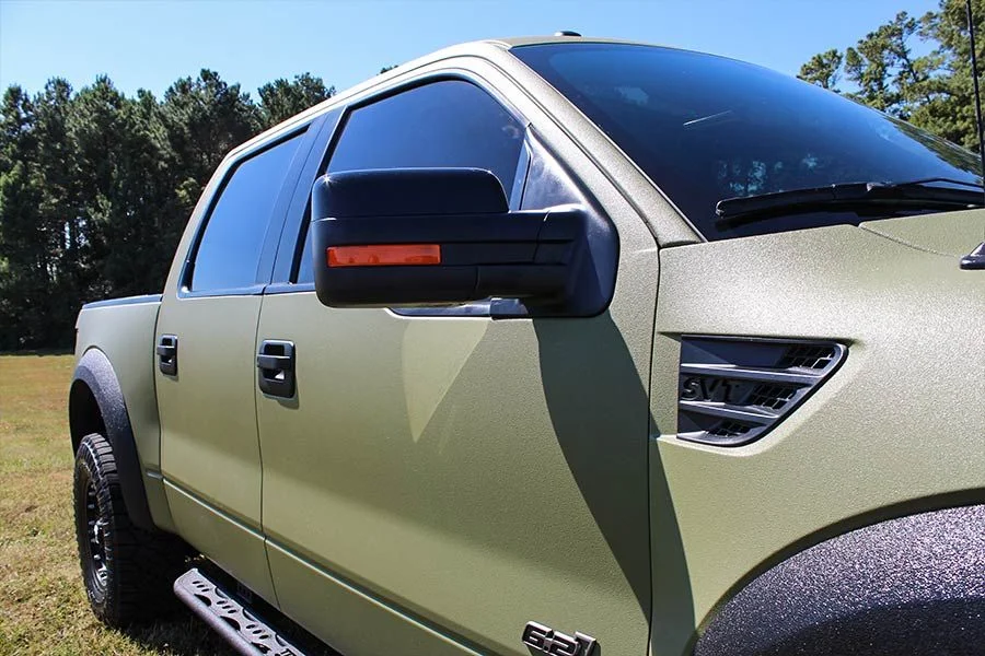

I have seen that one around as well. There's a fellow BBCNN member with an orange 40 that was Raptor lined. I have a box of tintable Raptor Liner on my shelf, just trying to decide on the appropriate color. I am probably going with some sort of green. Here are two shots (though not TLCs) that inspired me to do Raptor Liner:
full
(This might be LineX, but the effect is the same)
full
Here is a video on LineX Ultra, same concept. Easy maintenance, improved panel protection without using bash plates.
Do a Google image search for Raptor Liner and you'll see some sharp examples. There are quite a few videos out there too. It is quite versatile and very forgiving when it comes to application. It doesn't run or fade and can be tinted in virtually any color you want. It can be applied in several different textures depending on PSI level and can be reduced and shot on with a LVHP paint gun if you want it super fine. I will share shots of mine once I finally get around to doing it.
