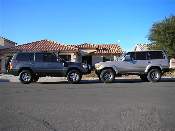

An ARB/Slee'd 100 is 5" longer than and ARB/Slee'd 80. My frame cut 80 is 18-inches shorter than my 100 and 13 inches shorter than an ARB/Slee'd 80. Imagine how that helps in the bad stuff.
You should do it! Look at the length difference. We need to get a 100 down-sized like my 80's:

must say that the difference in approach angle in John's photo up there is rather stunning...

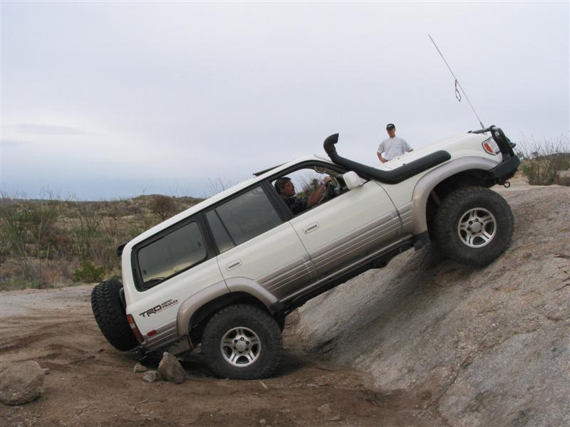

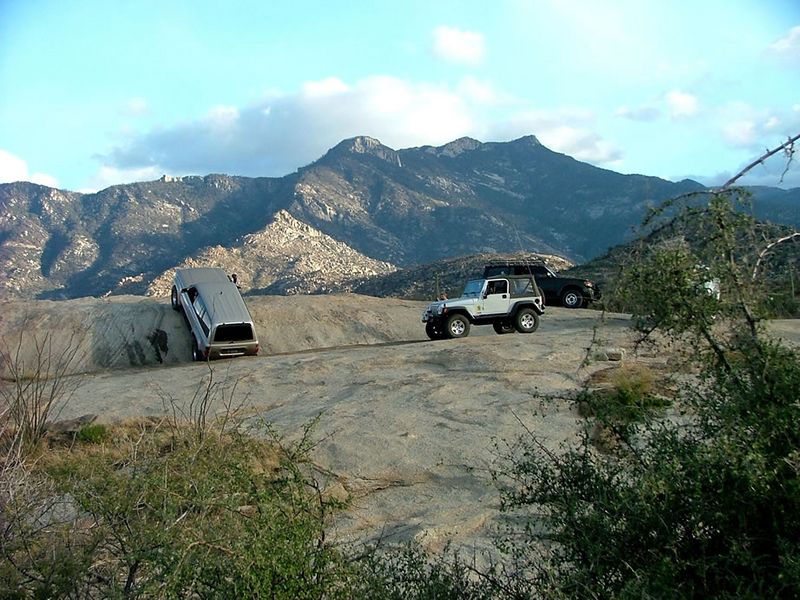

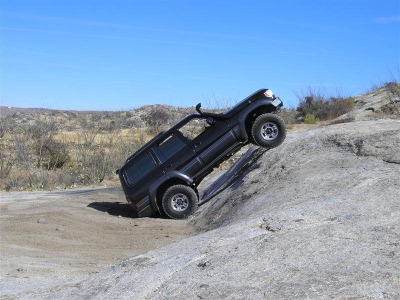

Like these:
Top: Loaded 80 with 4.5" lift.
Middle: Cut 80 with 3.5" lift.
You'll notice that the white/silver truck had to move way down the rock to a less-angles part. He's draggin hiss rear even at this angle. The bumpers hung it up and it couldn't climb. You'll see by the bottom angle that my 80's bumpers are even just clearing. A typical 80 has to move way to the right by the Jeep. The 100 even more. Look at where the 100 has to go! Plbbb! I want a cut one!
