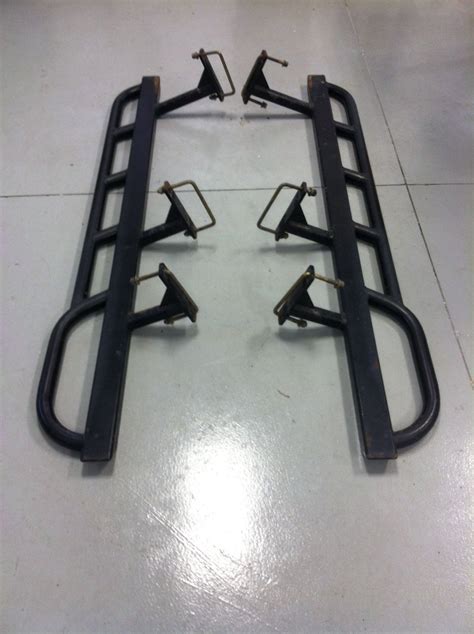

The difference between the two is Non AHC sliders have a third slider to frame brace in the middle of the slider. On AHC equipped trucks that third brace would interfere with the AHC accumulator.
AHC Sliders:
Metal Tech 100 Series Land Cruiser/LX470 Sliders
Regular Sliders:
Thanks, that's helpful and explains why Metaltech works for both setups since that's only two attachment points. Any sense how much more rigidity that middle brace adds?
