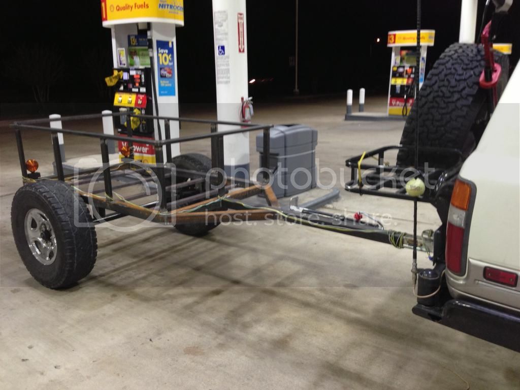

Hey Guys,
I'm building a 4x6 utility/camping trailer and need suggestions for a leaf spring that would be suitable for its light (under 1000lbs) loads.
I currently have 3500lb springs since it came with the 3500lb axle kit and they are way to stiff. I even removed 2 of the leaves and it is still too stiff, I guess mainly because of its short length.
Here is the trailer:
Nice looking framework.
Hard to determin the springs unloaded and unfinished.
Thoughts on adding shocks to smooth the bounce?
I would skin the trailer fill it full of geat then decide.
Post more pictures as you go.
