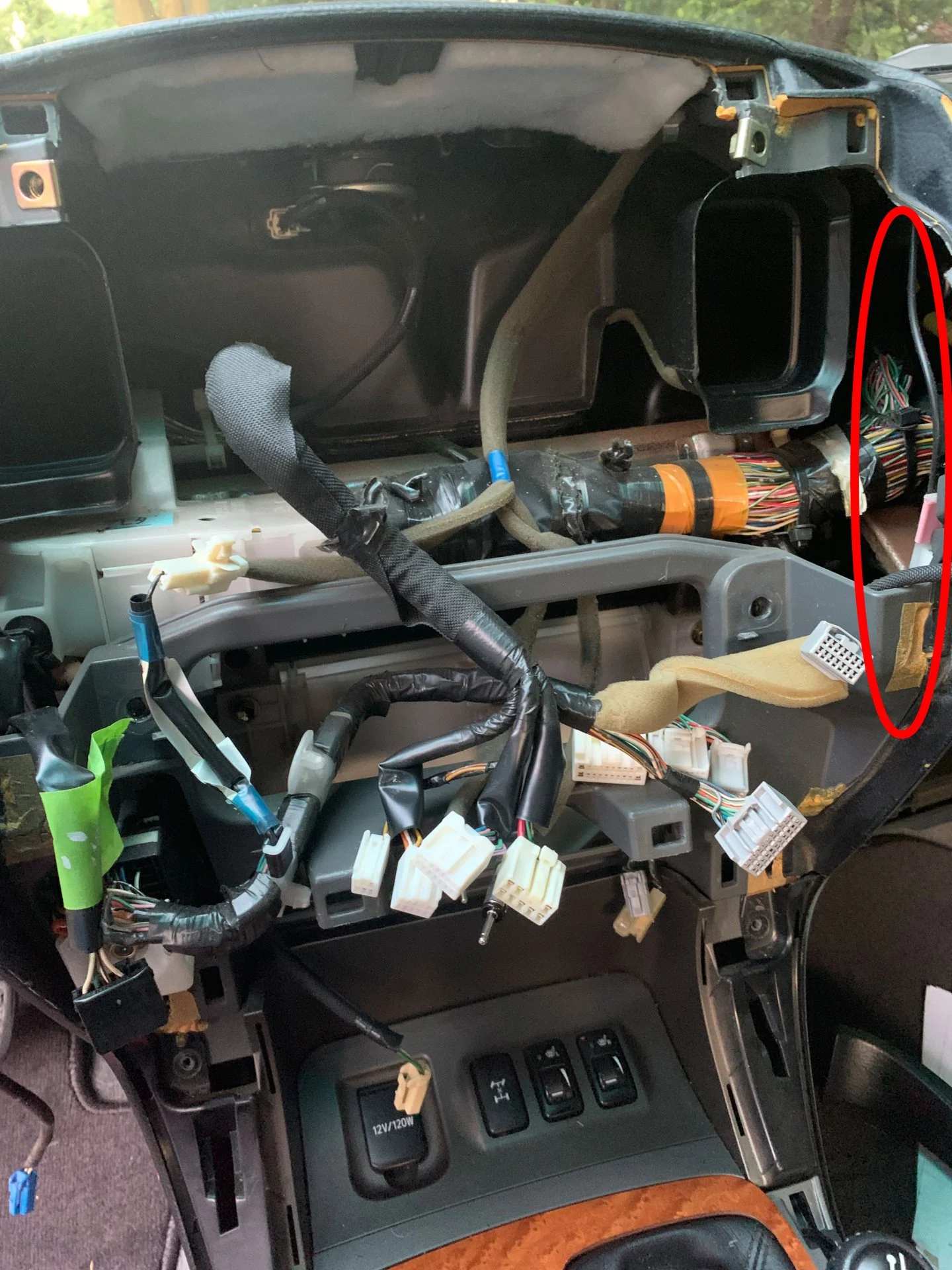

I just decided to undertake replacing the old cracked dash panel on my 03 GX470. I was fairly meticulous about labeling things to make sure I put it back together correctly. Everything went great but I have come across one wire that sits somewhere between the radio and glove box. I cant figure out what it goes to. I have circled it on the photo. I can take more pics if needed but if someone can tell me where this connects I would be very thankful.

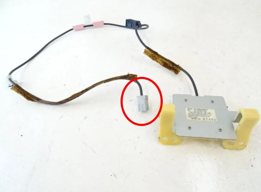

So I Have determined it is the gps antenna wire but I still cant find where to attach the circled connection? Any help?
The GPS antenna routes down the center console, along the transmission tunnel and under the front passenger seat where it connects to the navigation computer.
