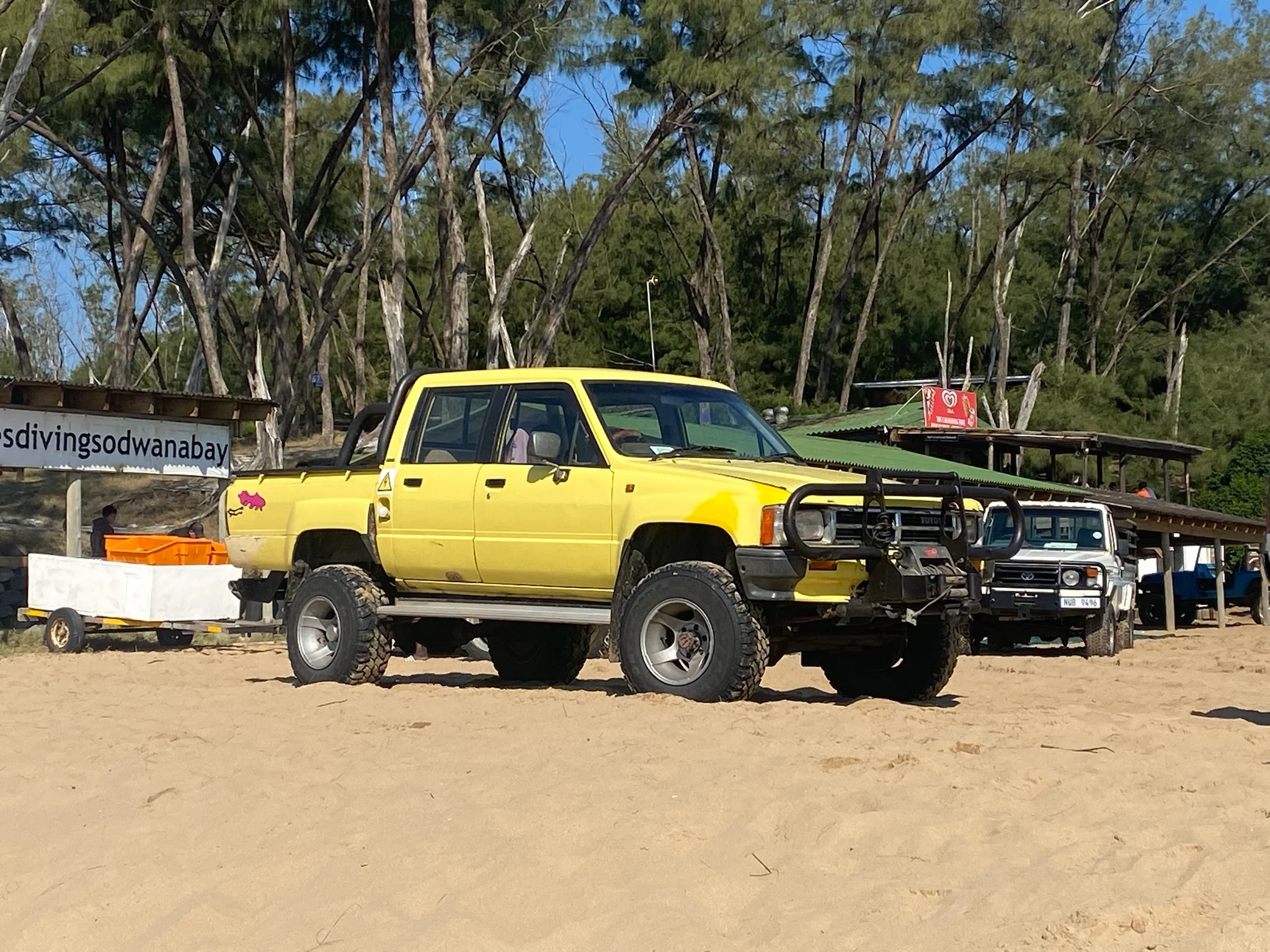

Saw this on a recent trip to South Africa
