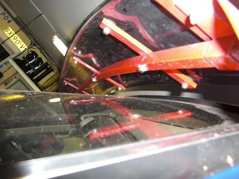

Sved, can you post up any more pictures of your sun visor specifically the underside? I'd like to see what kind of structure it has underneath the black plastic and how it hangs onto the rain gutters.
Thanks!
Here you go,pictures from underneath ,topview and leftside mounting Point.
The whole visor is attached with 6 screws.I painted mine red.Originally it comes with a black frame.

Very cool Sven, thank you! The ideas are bubbling now :D That's the same one as the first picture, right?
That visor is pretty low to the windshield and at a steeper angle than I thought it would be. I was imagining that it would follow the roof line over the windshield, not follow the windshield like that.
Sven, those 6 bolts, those go through holes that are drilled in the rain gutter? Does it use another bracket on the top portion of the rain gutter or just regular lock nuts?
I drilled holes and treaded M5 ,so the holes are not all the way through the rain gutter.
The metal is thick enough for sufficient grip with M5 bolts,but i do want to exchange them with nutserts.
Yes, all the pictures are from the same sunvisor,which has been mounted on my truck for the last 18 years.So it sits rocksolid.
You have a Little room to play with the mountingposition,so it can be mounted higher towards the roof,like the grey cruiser in the first post of this tread.
