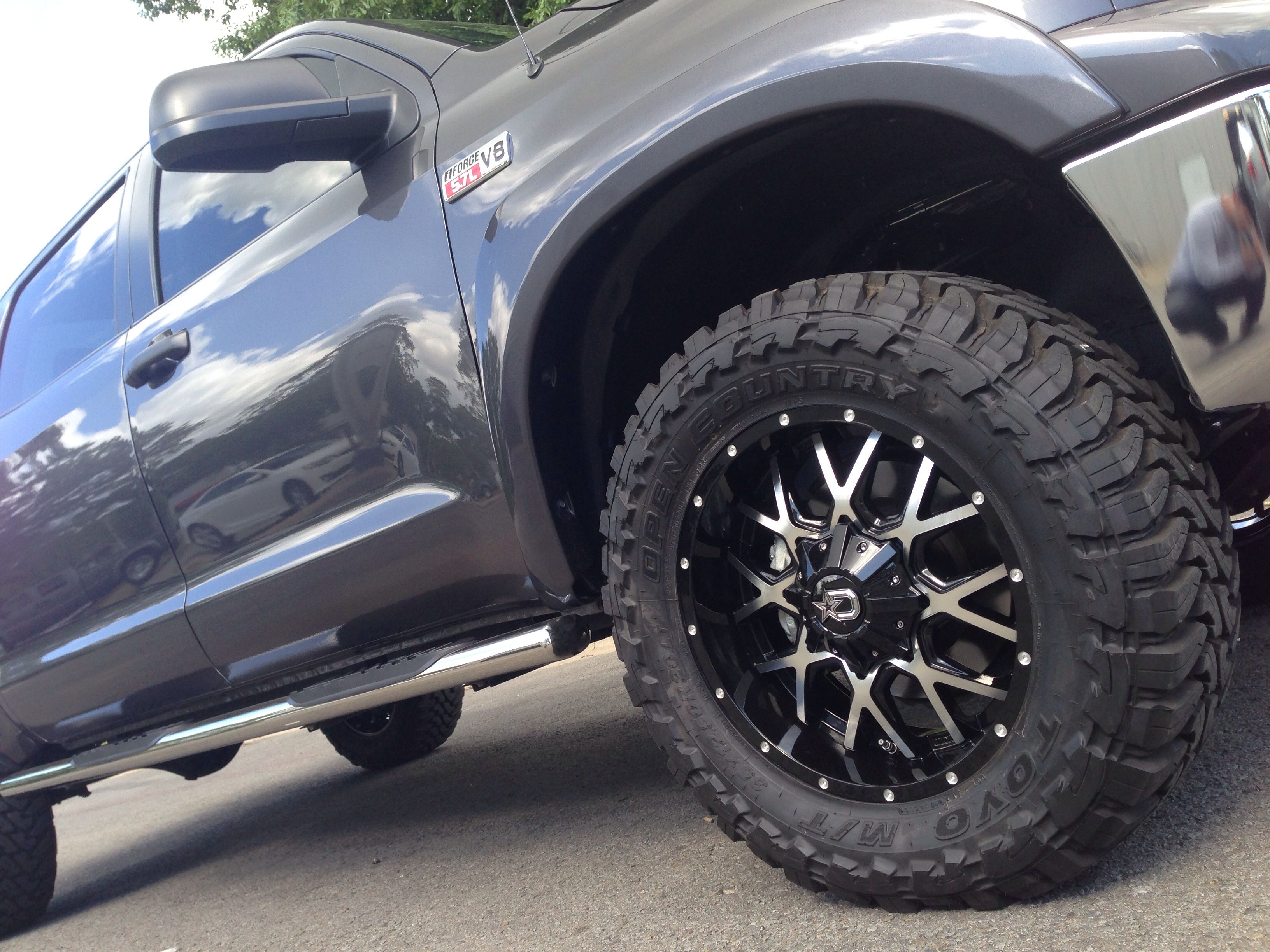

Here is an example of the combo (Looks Awesome!!!)
See the source image
