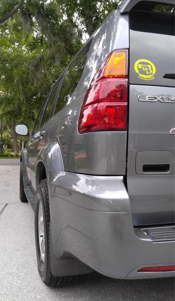

All I want is just wider look, as on picture.

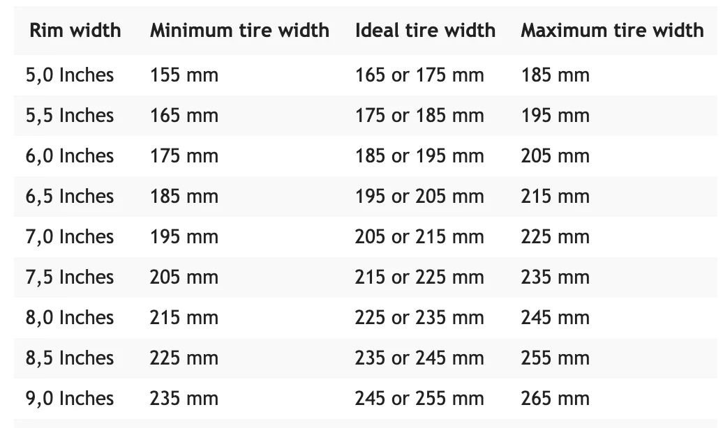

Most tire manufacturers have a recommended rim width for each tire size. 265 width tires usually fall within 7 to 9 inches, but you should still verify to be safe. That being said, an 8.5 or 9 inch wide wheel would have to be zero or negative offset to clear the suspension components and poke out of the fender well slightly. there are a bunch of offset calculators that you can play around with once you find a wheel you like.

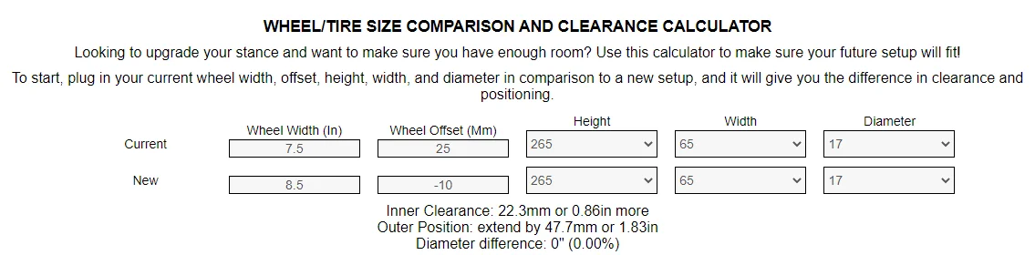

For your reference, the stock wheel is 17 x 7.5 with +25 offset. the more positive the offset, the more they are tucked into the wheel wells. Going negative pushes them out. Below is an example of a 17 x 8.5 with -10 offset vs stock:

According this table it's seems to okay. The questions is how it will look.

It will be pushed out about 1.5 inches in total. ~1 inch from from the offset change, plus 1/2 inch from the rim width change (1/2" increase on the inside and outside).

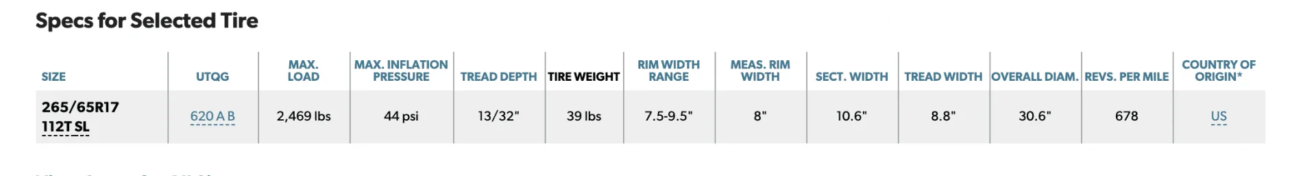

In terms of tires, I stoped on Cooper Adventured AT3 4S. According tirerack, it will fit 9 width rims. But again, I'm not sure if it's a right choice, maybe I should go with a different size?

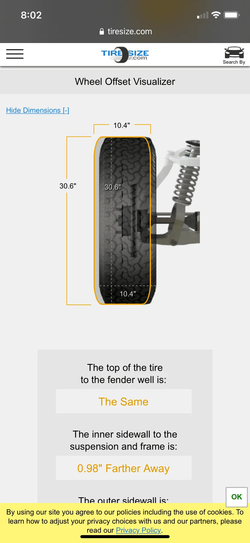

First, you need to Google various tire calculators to show and illustrate what your desired rim size and offset do to your stock tire configuration. Some tire calculators draw pictures comparing your current setup vs your desired setup.
