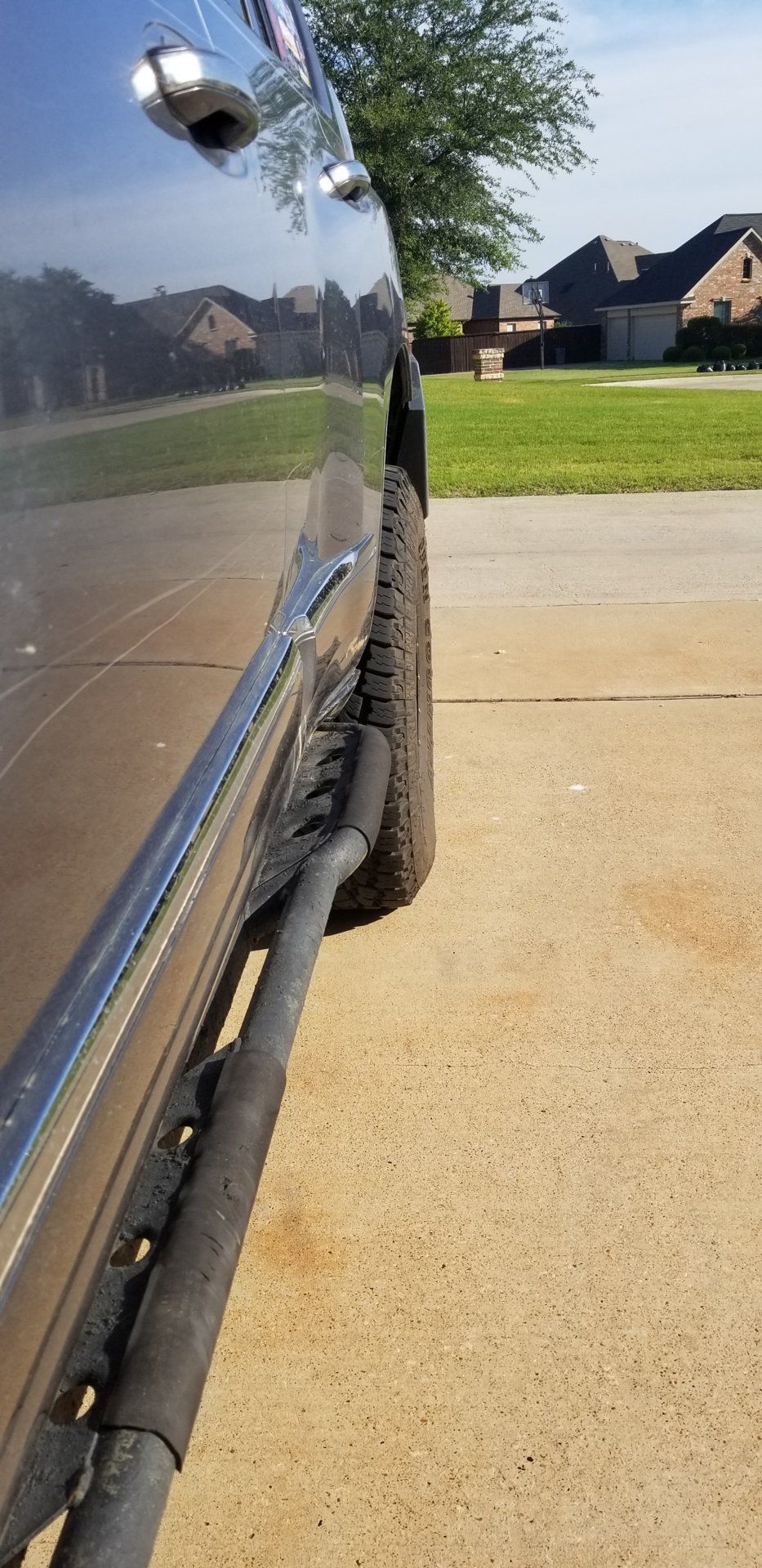

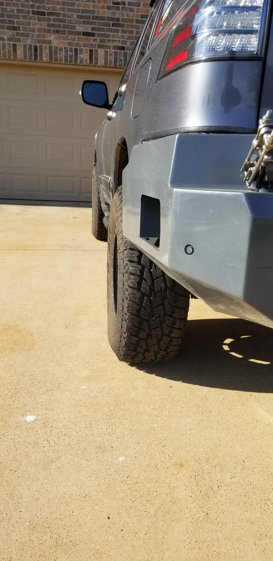

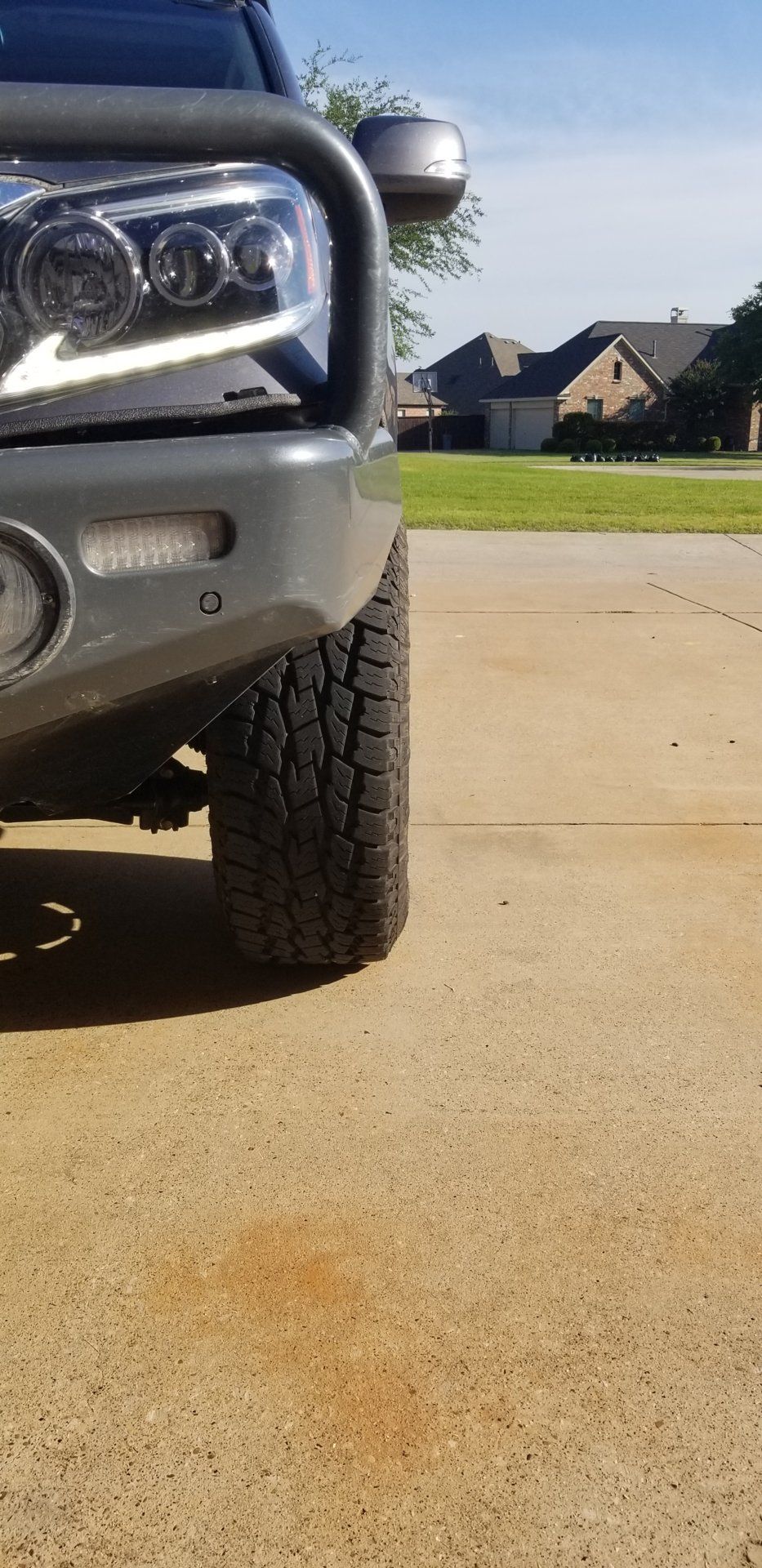

Here are some that show the stance on my 460 with SCS 17x8.5 (notice a little wider than 8") wheels with a -10mm offset, wearing 285/70/17 Toyo AT/II tires. I hope this helps.
