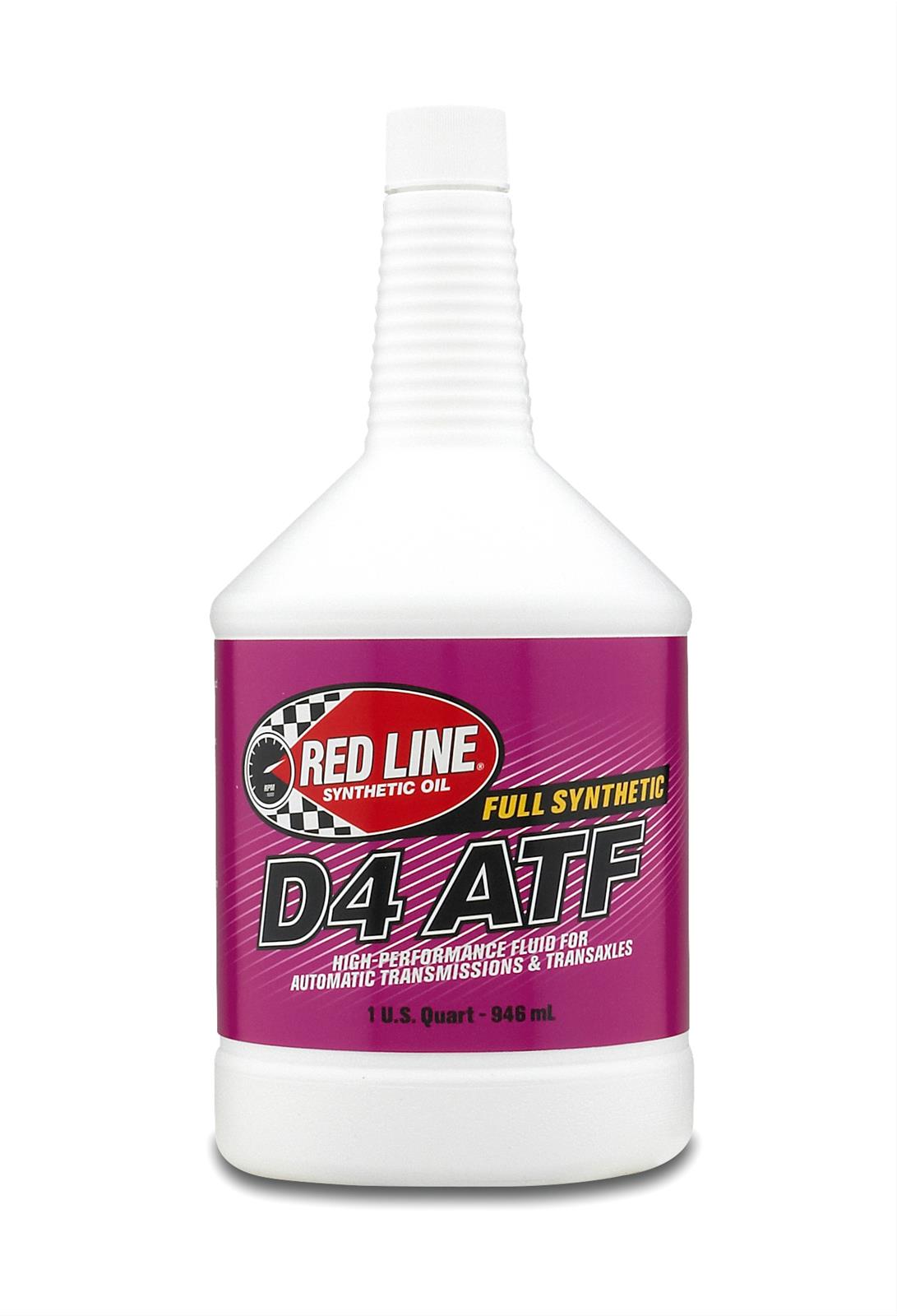

Does something like using Redline D4 ATF mitigate this issue all together?
Your thoughts please?
Fluid boiling will introduce air bubbles into the hydraulic circuit. That could airlock the circuit or the pump could lose prime.
Higher performance fluid could help, but IMO that's only a partial mitigation as the fluid could continue to climb in temperature without sufficient cooling. Also the pump, hoses, and seals can all be compromised affecting durability when working at elevated temps long term.

1.2 liter as I understand. Was not able to exactly measure when I flushed. Used 2 quarts or almost 2 liter of new redline D4 in the process.

I actually bought a hose and fitting and clamped it to the return line and had it hanging into empty gallon motor oil can secured, then with a funnel and ready with two 1 quart bottles of redline D4 had my wife start, turn full each side once and shut down again all in about 15 sec while pouring in the redline D4. It worked but it was arguable pumping to fast, may even have pumped a few seconds with low oil at the suction side.
Then I pulled out the oil out of the reservoir and reconnected the return line. Filled it up using the remaining of the 2nd quart bottle and started the engine to let any air out.
Worked but I would recommend jacking up on each side (I actually have good capacity jack stands) then have a helper move the steering wheel side by side (accessory mode, do not start…).
I just do not like dropping the cruiser onto jack stands more than I need to, but this case I should have.
All in all now with redline D4 full synthetic in place I am going to just replace the reservoir and change by dilution every 10k miles (easy to remember at for me 40k, 50k etc).
Ok. I replaced all the fluid with Red Line D4 ATF. It doesn't seem to have fixed anything. Maybe it is a little improved, but it's not fixed. Next step is to install a second oil to air cooler.
