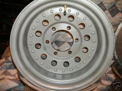

I just put a set of American Racing Outlaw II look-alike rims on mine, 15X8 3.5 backspacing, "mag" type lugs (which require washers). The photo below is one of the set that I bought. I was told by SOR that for a 60-series, wheels have to be a bare minimum of 3 3/8 backspacing (without spacers).
I paid $150 via ebay (plus $65 shipping) and LOVE 'EM!
SEE THESE: http://cgi.ebay.com/ebaymotors/15-X...64697QQrdZ1QQsspagenameZWDVW#ebayphotohosting
IF YOU BUY THEM, YOU'LL LOVE THEM (no I am not the seller nor do I know the seller).
