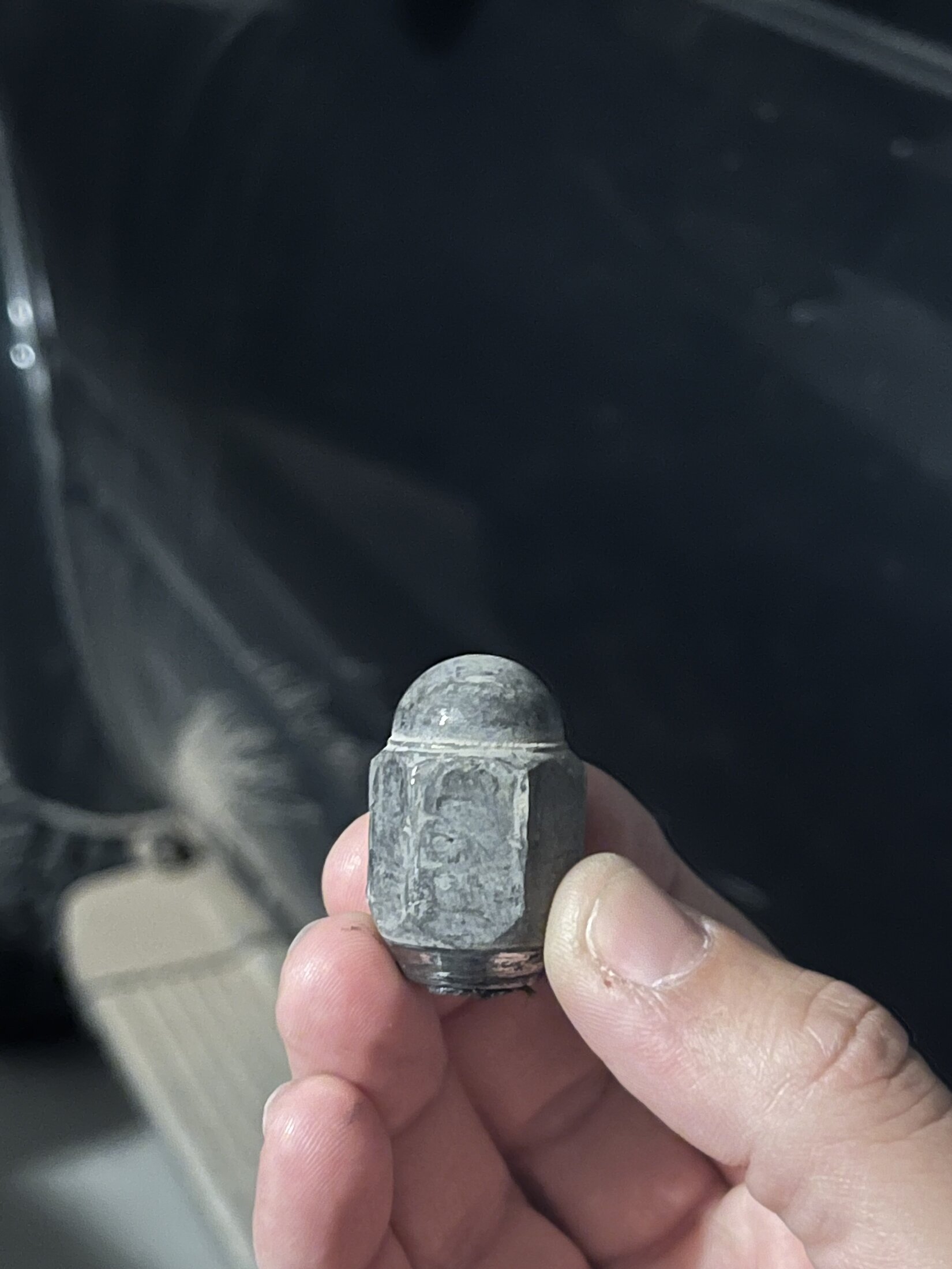

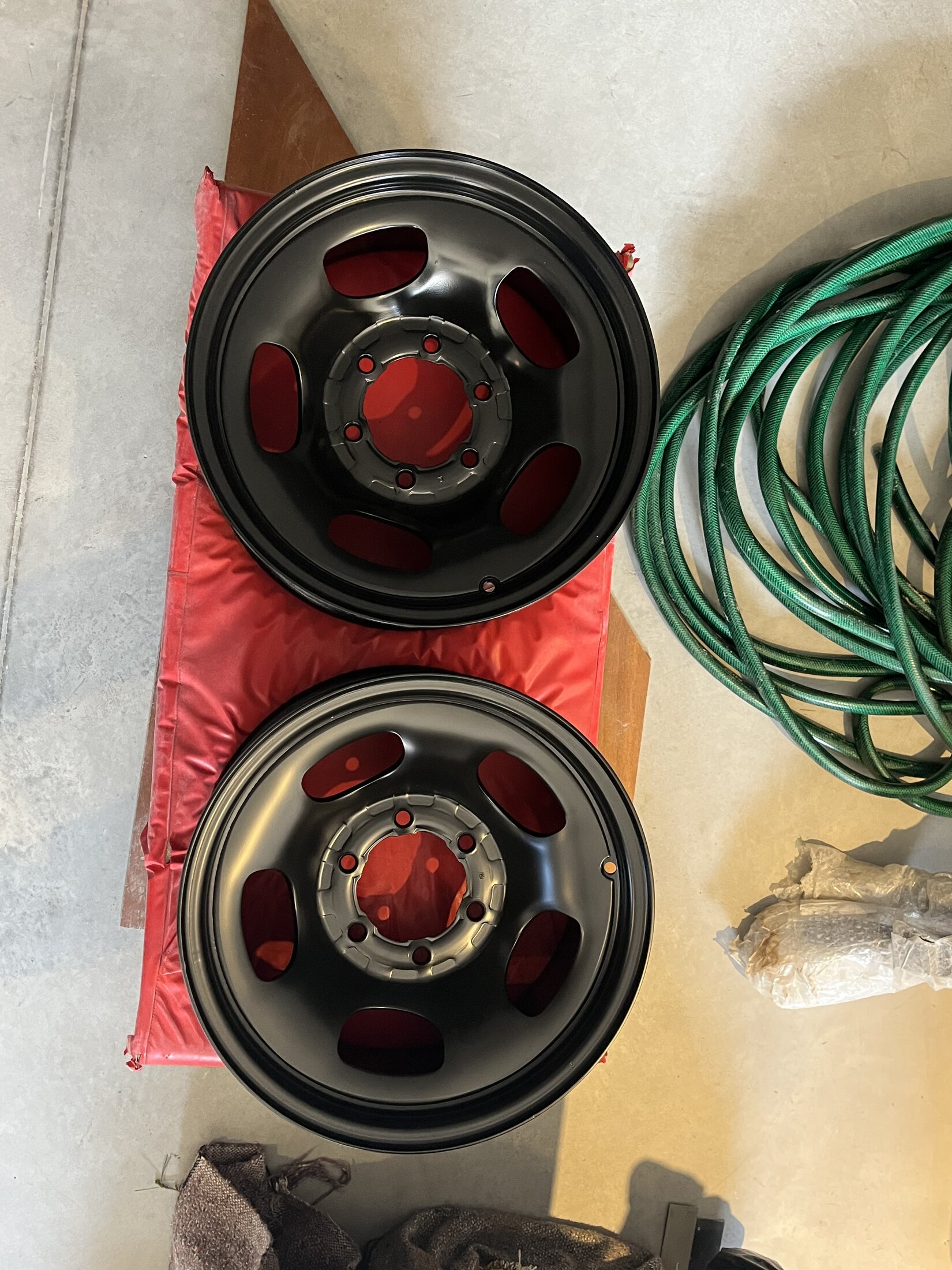

Hi guys. So I have a FZJ80 Us spec with aluminum wheels. I recently got myself a set of 4 OEM 80 series steel wheels. I was wondering If I could use the same wheel nuts or should I consider gettin a different kind for the steelies?
Regards!
The typical OEM 80 series and lx450 wheel take shank style lugs. The steel wheels you already run probably use a tapered style lug nut. If the two surfaces look the same, they are, if they look different, different lug nuts will be needed.

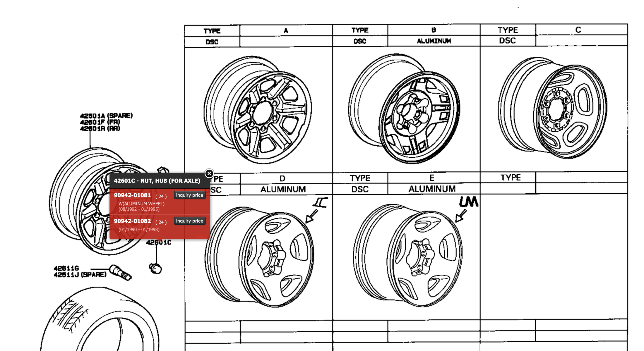

Credit for the image easily found via search.

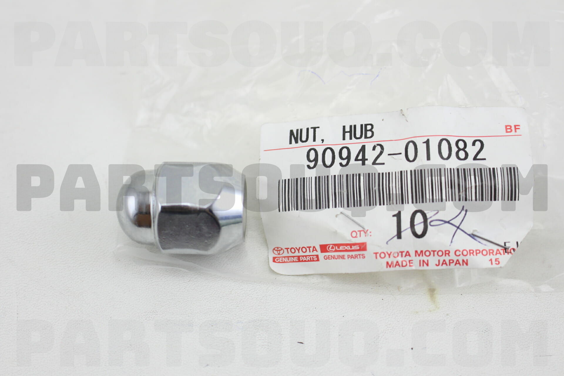

This is what I get from the parts manual

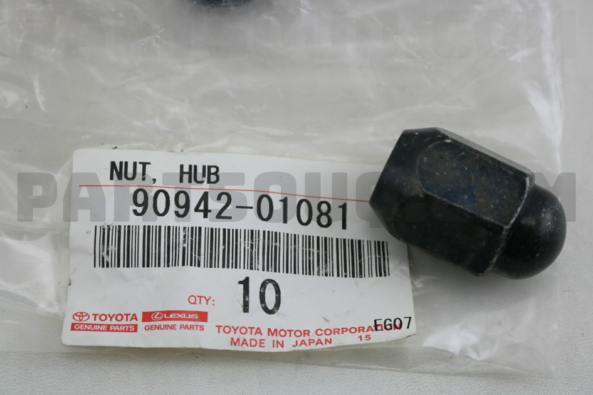

90942-01082 for steel wheels
90942-01081 for alloy wheels

It is pretty simple. The US spec FZJ80 wheels lugs are either acorn (93-94) or shank (95-97) Your steel wheels will take acorn. That is about as complicated as this can be made. ;)
