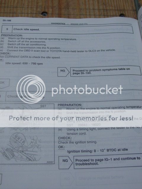

Ignition timing is 8 to 12 degrees BTDC with TE1 and E1 jumped.
there we go. now, with te1/e1 jumped, how do you adjust the timing?

He doesn't know what he's talking about. Jumping TE1 and E1 was used for 85-95 Toyota 22RE and 3VZE engines. That was when there was no ODBII to interface with.
Like I said, there is no way to "lock-out" the computer to set a base timing. It is set at 0* or TDC. Period. Then the computer takes it from there...
That came right out of my 99 FSM :censor:.

The FSM says nothing about adjusting the timing just checking it.
I bet, right next to the part that says to turn your coil packs to adjust timing, right...? :hhmm:
It's all computer controlled, you can't manually change the timing on a 5vz-fe. The only way to do it is to add a piggy back system, but leave that to the professionals.
