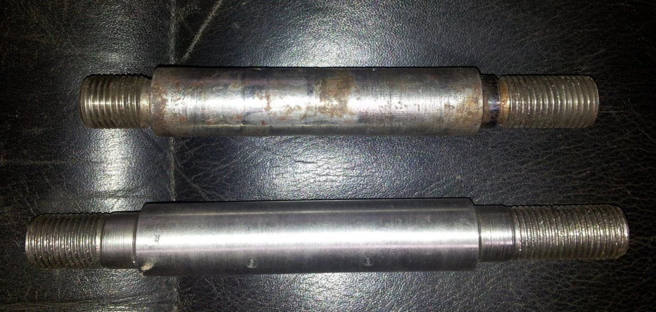

What steel needed for STRONG shackle pins?! Broke my OME ones!
re_guderian - can't get an OEM spring to check, but my OME spring I could measure when I lift the car up. The shackle pin to pin distance seems to be the same on OEM and OME.
Jim - that's the problem, nobody here can tell you what bolts they sell, it's just gambling... so I better stay out of this and bought 4140 steel from a trustworthy supplier.
I will try to do solution 2 with 14mm shoulder, also for the front pins. Will drill out the rear shackle brackets and also the front pin bracket to 14mm and lock the pin to the brackets with the nut before installing. Should then be the same as the stock setup that screwed into the bracket. On the radius of the undercut (that will be AFTER the shaft so no shear force there!) I am aware and will tell the machine guy to take care of!
Looks like it's also the same pin on the front... just the brackets are 6mm and the rear ones are 8mm, but otherwise the same pins as much as I can tell. Will replace the front pins too, they also showed lots of surface wear when I replaced the bushings in Quito.
Thanks guys for your inputs!
Sounds like a plan!
I'd make sure to change all of them while you're in there, and have a couple spares made while you are at it.
yeah, minimum order quantity was 4meters, enough to make 24 pins that are little bit longe than the stock ones... I probably will make 4 with a 8mm shaft length (since the rear bracket is 8mm thick) and the rest with 6mm shafts (front brackets and pins on the frame). The OME ones are all with 4mm shaft, although they could go up to 8mm on the rear. I guess it's a generic pin they might use for other applications.

Thanks for the offer! Already picked up the 4140 steel from Lima and the machine guy is just working on the pins I redesigned...

so, got the pins machined. I had to finish the guys work because he was 5 days late but he did a good job. It's just that they never finish when they say in this countries, it's always the same "mañana" story.
I drilled the shackle brackets with a 14mm drill and torqued it all to 123Nm as the manual says for the front pins. Now I have on both sides a 14mm shoulders that is much wider. The rear bracket is 8mm thick so I made also the shoulder 8mm, the OME piece has a way too short shoulder and this now on both sides. I hope it holds now for good! Here pictures of the pins and with brackets.
