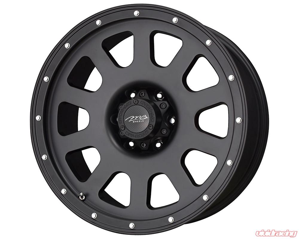

Can anyone tell what brand these are? There's a forum member WhiteH2O that has them and I contacted him via private message, but I'm not sure he'll reply anytime soon.
Found the answer in a post by @WhiteH2O
They are MB Wheels 352 17x9 with a -12 offset and can be found at Discount Tires. For comparison, several web sites say the factory OEM wheels are 17x7.5 with a +25mm offset.

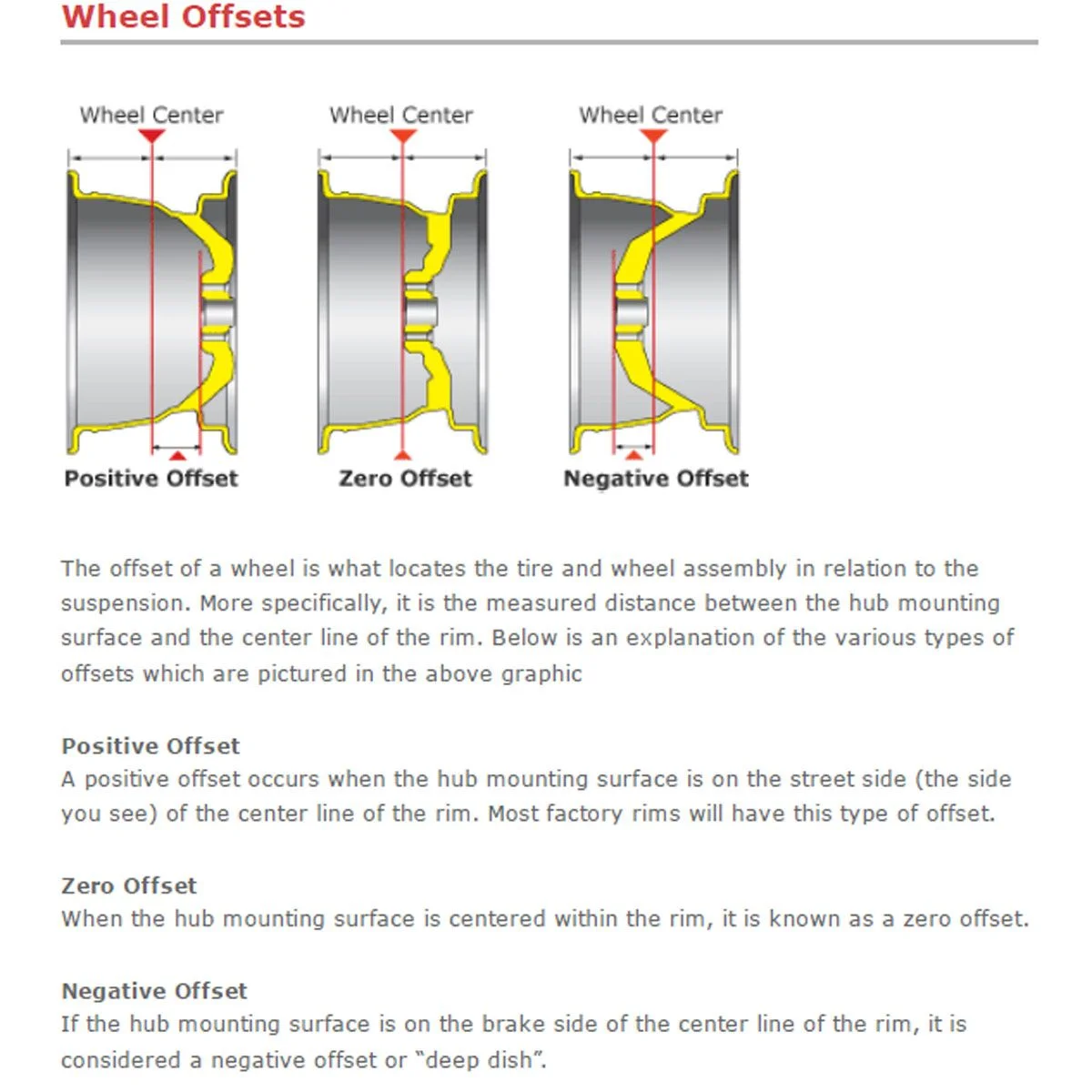

View attachment 1520674 View attachment 1520675 View attachment 1520676
Wheel Offset Calculator | 1010Tires.com Discount Online Tire and Wheel Store
That may help visualize things.

Oh the link to the offset calculator is awesome. I had calculated new offsets using a spreadsheet, but the calculator is much easier to use!
