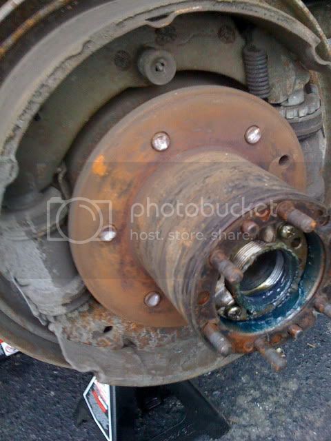

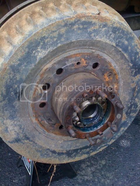

Well I know i have been afk for a while, just to much going on at home. I just finally got to figure out what happened to Oswald several months ago...
turns out i came up with a great way to remove the wheel from the truck without taking off the lug nuts....
Well atleast this is better then having to drop in a new tranny or rear diff...
loose lug nuts? Drivers side? or did you have spacers on it?

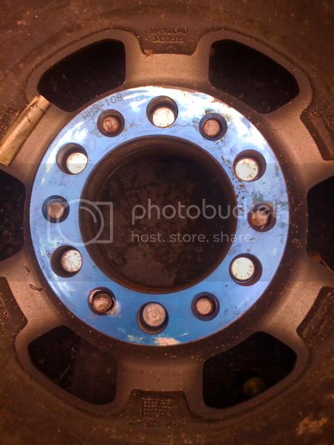

It is on the Drivers Side (RHD truck) and the lugnuts were tight. I used spidertrack spacers on it with new lug nuts torque to the correct specs. I just think that the 29yo bolts could not stand up to the stress. I'm just glad this is a FF rear... otherwise it would have been real bad...

I'm very glad that my son and I are ok. I had just dropped him off at school 15 minutes before i think the final one broke. As for the spacers, I'm just happy i had them on there, if not for the spacer then the wheel would have fallen off. I'm not sure the spacer caused it yet...

Got any close-ups of the fractured studs?
that is next. it looks the my that metal fatique killed 5 of them when I tightened them down or soon after, and that one was left holding the wheel.
