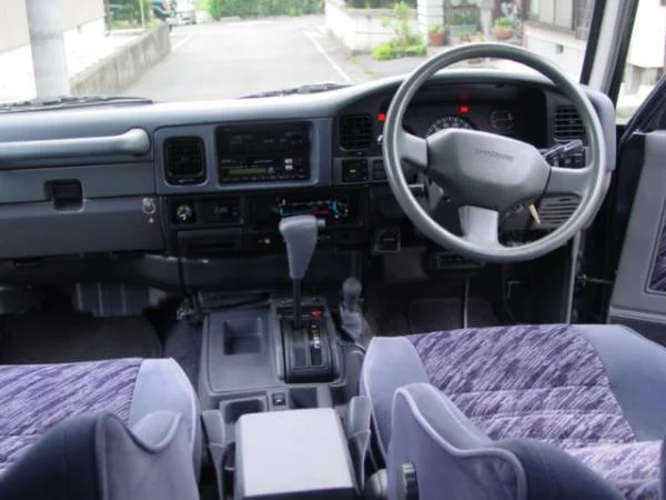

What model and year/s 7x's series did this style Dash come in, can you get them in Aus, will they fit in a 79 ute

It looks like an early model Prado (early 1990s?) panel.
Don't know whether it will fit a 79, though.

A LJ 78 Prado dash looks like any other 70 series dash, I am wrong buth with the flat windshield and 70s doors that must be a PX 10, send the cheque to my accountLOL LOL
Looks like the dash in the last of the 70 series prado,circa 93-94.
Im guessing it would fit in theory as its the same width and the binnacles and vents are more or less in the same place.
Very uncommon in oz,private import model only .
I dont think they made a lot of them.Some markets kept the old dash and body until 96 like the Red Cross models.
The rounded dash is probably for Europe and Japan only
I have never seen that Dash in the UK on 1KZT or 2LT. Toyota stopped selling the 70 series here around 95-96.

Just noticed the seats are different on that picture as well, well the curved arm rests, or maybe its just the angle of the camera?
Anyone know if they are available or are they worth bolting on to rest your arms on whilst on those long trails?

Europe never got that style. I'll take the classic sheemetal dash any day ovet "that thing" :D
Well someone must have got it and that one is RHD,so maybe Japan only.

my guess would be a prado dash in an hzj73.they do bolt straight in and its quite popular over here(nz)just for a bit of a change from your average 70 interior.i say hzj coz if you look to the left of the steering colom you can see the majic button.well.....switch actually.
ahh nice to no thanks all for the info might have to look into a nz one soon
