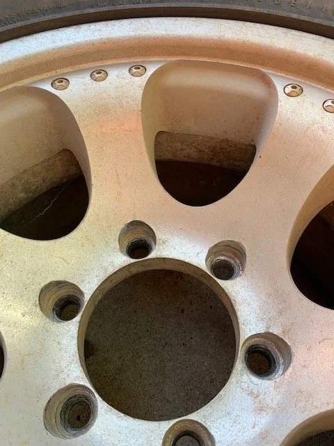

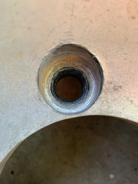

I have been running typical Acorn type lug nuts on these rims. Not sure if they are correct. Looks like I might need the shank/washer type. Any expert advice appreciated. I ordered stock Toyota's but shank diameter is too big and washers didn't fit in holes. Please enlighten me. -thanks in advance.
The wheel manufacturer should state what type of nut to use for those wheels.
Looks like shank, but hard to tell if there's a bezel there or not.
Does the wheel move around on the hub w/o nuts installed?
