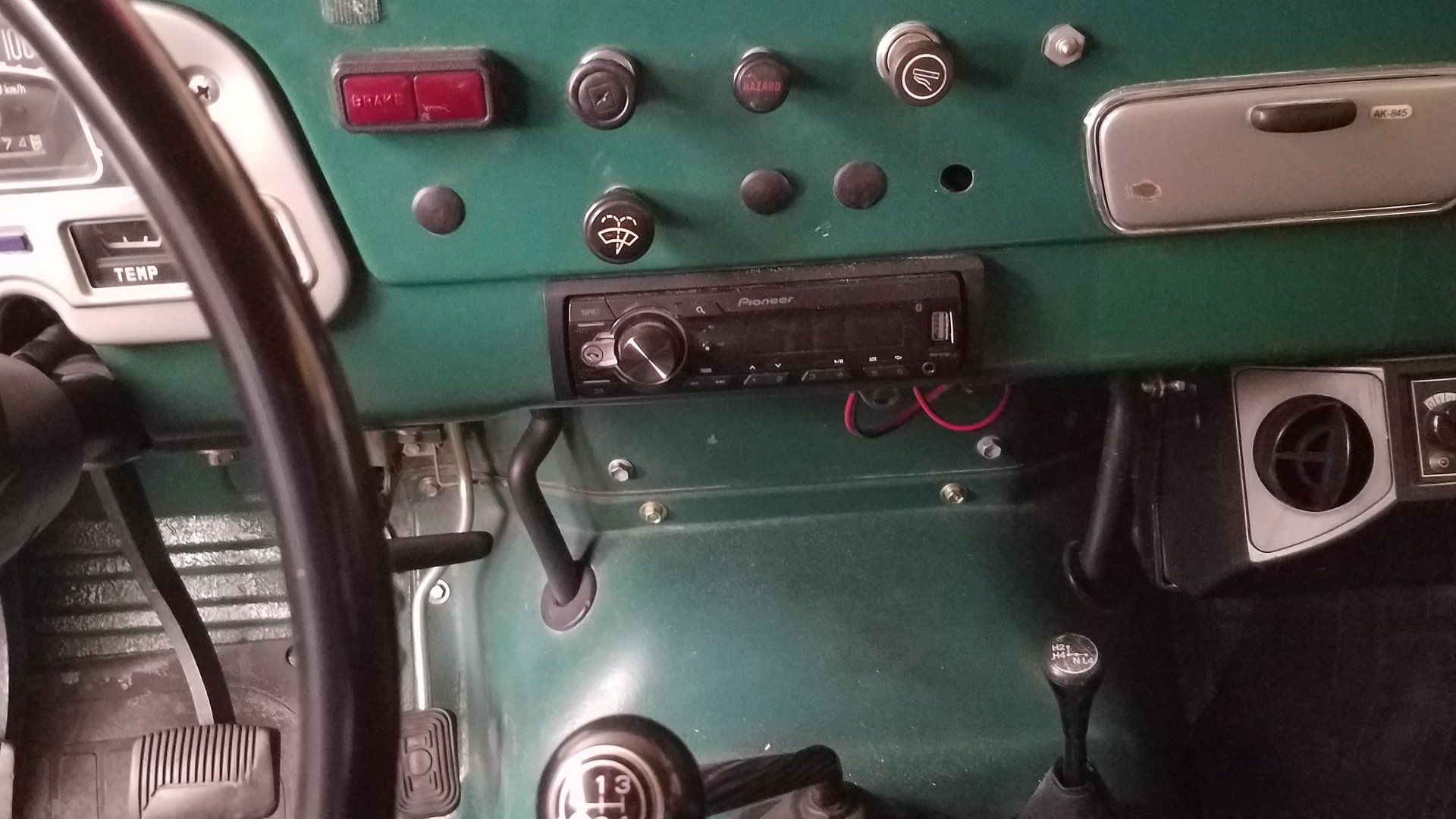

What is this?? (1 Viewer)
Found out the "what is this" was a broken on/off switch tied to the dome light. Removed the switch and my dome light works.
Another problem.... I noticed I was missing a high beam light blub in the instrument cluster. Replaced it and now it's on constantly except when I toggle the high beams on then it goes out. I expect the high beam switch is missed wired but to access it inside the steering column? Ideas???
