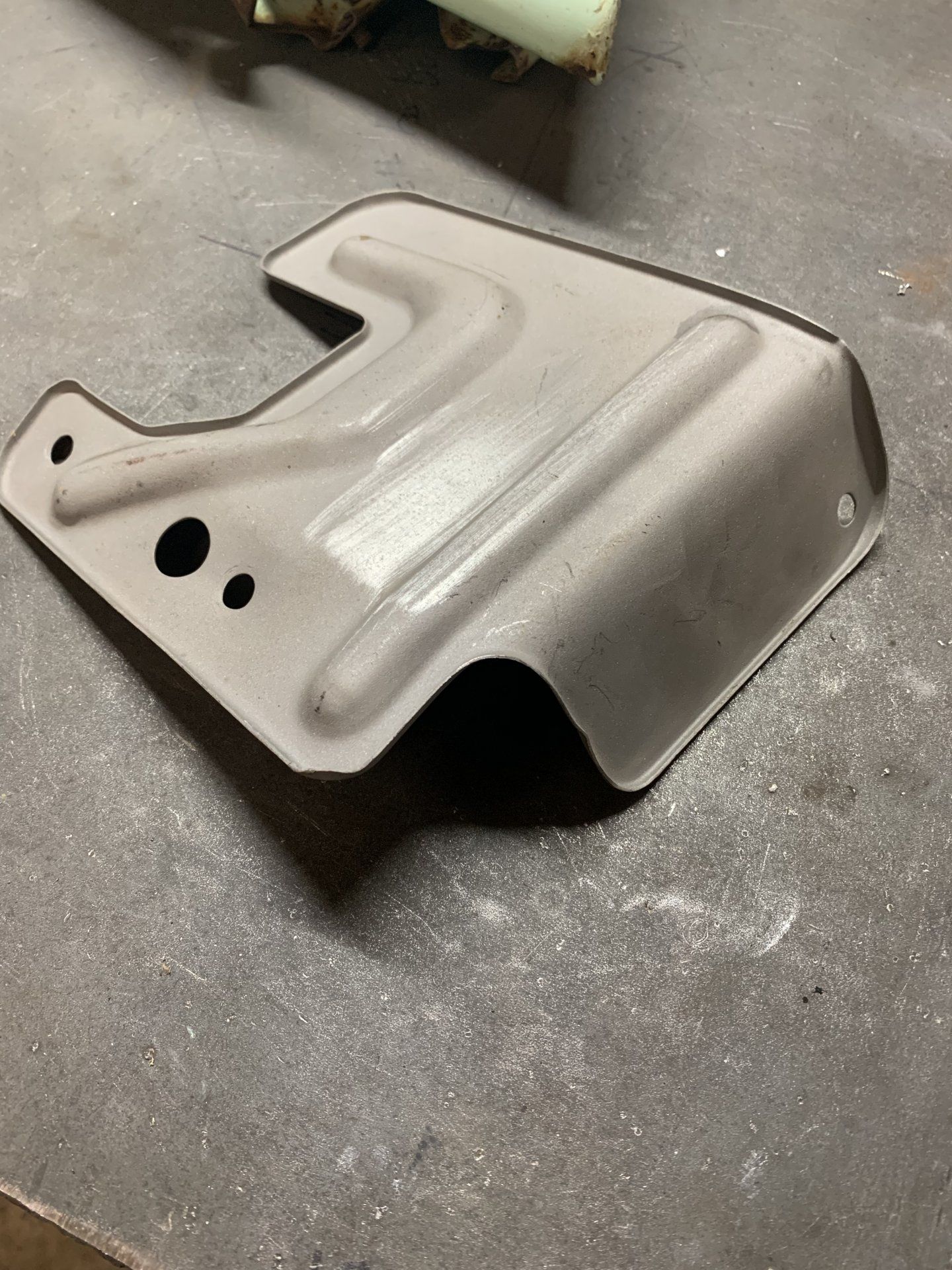

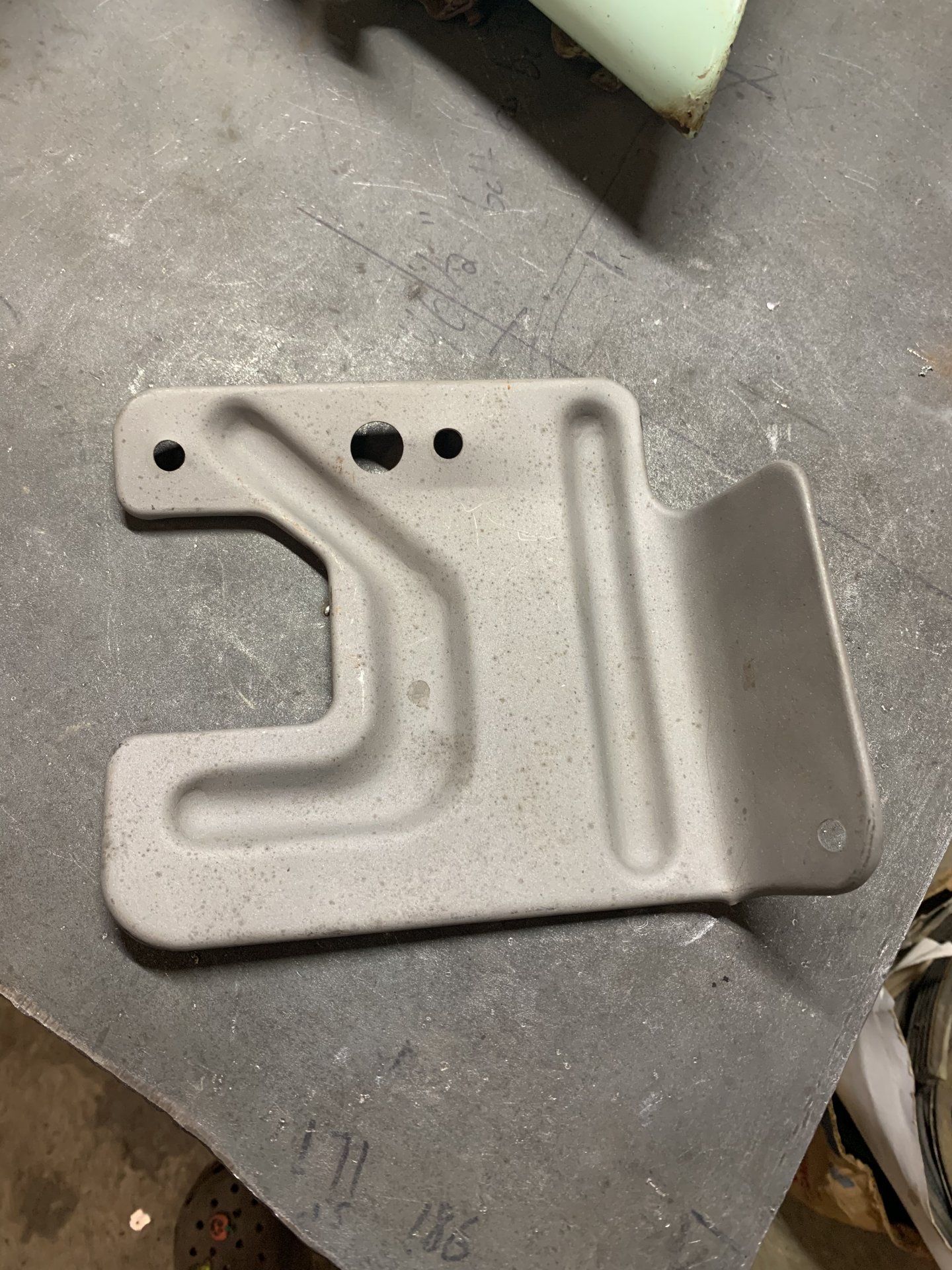

I have this shield or bracket for my 71; I cannot figure out where it goes from looking through pics. It was in a box with the battery mount but that doesn’t mean much. I assume it’s some kind of splash guard or heat shield. Just trying to sort stuff out for paint and this one’s got me.
Believe that has been bent and should be flat. Splash guard in the engine compartment. Check the frame on left side of the engine. Large hole will fit over a rivet on the frame and other two hole will line up with fixed nuts on either of that rivet.
I will check those spots out. My first thought based on size and shape was actually a steering box guard. If that’s the case; guess it goes in the matte black pile!
