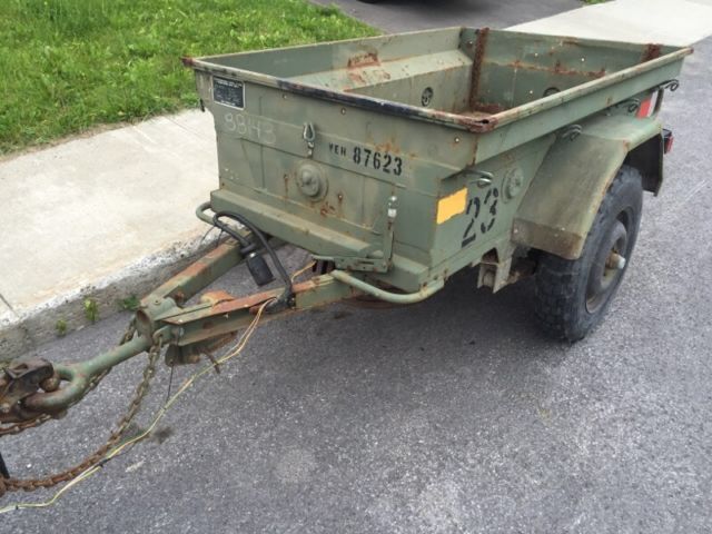

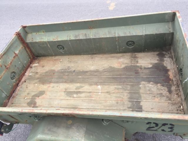

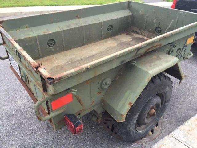

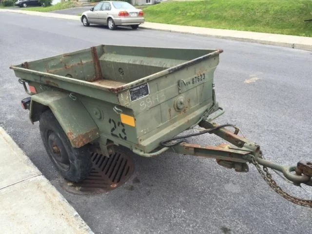

Came across this for sale, but something doesn't look right on the tongue. Did they all come with a support? It also looks like the rear was cut to form a tailgate. Price seems high for what it is.

Looks like the drop-leg is missing, but the mechanism is still there? It may have gotten trashed and they unbolted the leg and pitched it; there are only two bolts to take it off the locking mechanism IIRC.
The very rusty top rail is worrisome and it looks to have spread elsewhere. The tailgate is particularly problematic given the tub it was cut into is far from ideal. Whoever butchered it didn't even bother to shoot primer on the fresh wounds, leaving even more places for the rust to attack.
It's actually one of the poorest examples of a M101 CDN I've seen. Looks like the CF used it hard and then sold it to someone who kept flogging it in retirement. Looks to be ready for hospice care.:skull:

I thought the hand brake location was wrong. I was going to offer $400-500, but the ad is gone. Looks like someone already purchased it. There is another for sale in much better shape, but they wanted $1300!

Handbrake location appears correct to me, as that's where it's at on our M101.

careful on that trailer. It has no lunette and good luck finding one.

Thanks for the heads up on the missing lunette. Very clever keeping it out of the pics. Yes, nothing much avail the last couple years. I just did a Canada wide search on kijiji, and there is a nicely modded one for sale out west for $2600.
