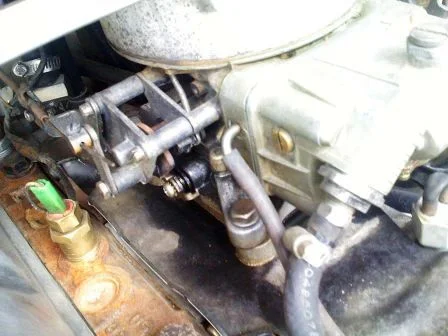

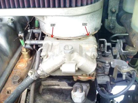

So I am trying to identify this carb so I can find a rebuild kit for it, not sure what I have here. The only place I can see numbers is on the top right up against the Downey air cleaner. Those numbers are 6387 on the left (pass side) and 6392 on the right (drv side). Neither of these pull up as anything on the Holley site. The only other numbers I can find are a slew of different pattent numbers.
Any idea where I may find a number of what this carb is? I did not see a "choke tower" referenced on the holley site to look for a number, hoping someone here may be able to identify or tell me where I may look to find that number.
That's a Holley 350 (#7448). I have a rebuild kit for it, and a 1,000 percent much much better way of hooking up the throttle cable. PM me for more info.
