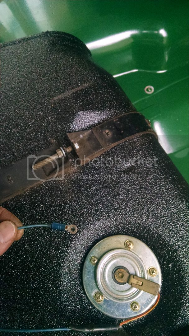

I hook up this wire to one of the screws on the sending unit it was the only obvious spot .does this seem right.the gauge does not work before it use to at least move
Yep, it grounds to any one of the 5 screws.
Have you checked the splice in the Yellow-Red wire? If this isn't your splice, I would trace the wire from the sender to the gauge and make sure it's good - or test continuity on it.
You can also pull the sender and test it with an ohm meter... or ohms function on a multimeter.
I don't recall what year FJ40 you have... here's what @Downey says the resistance should be:
(a) Up to 9/72 is 100 ohms empty, 3 ohms full, but with a 7 volt drop built into the Toyota sender.
(b) From 9/72 is 120 ohms empty, 17 ohms full, full 12 volt operation.
