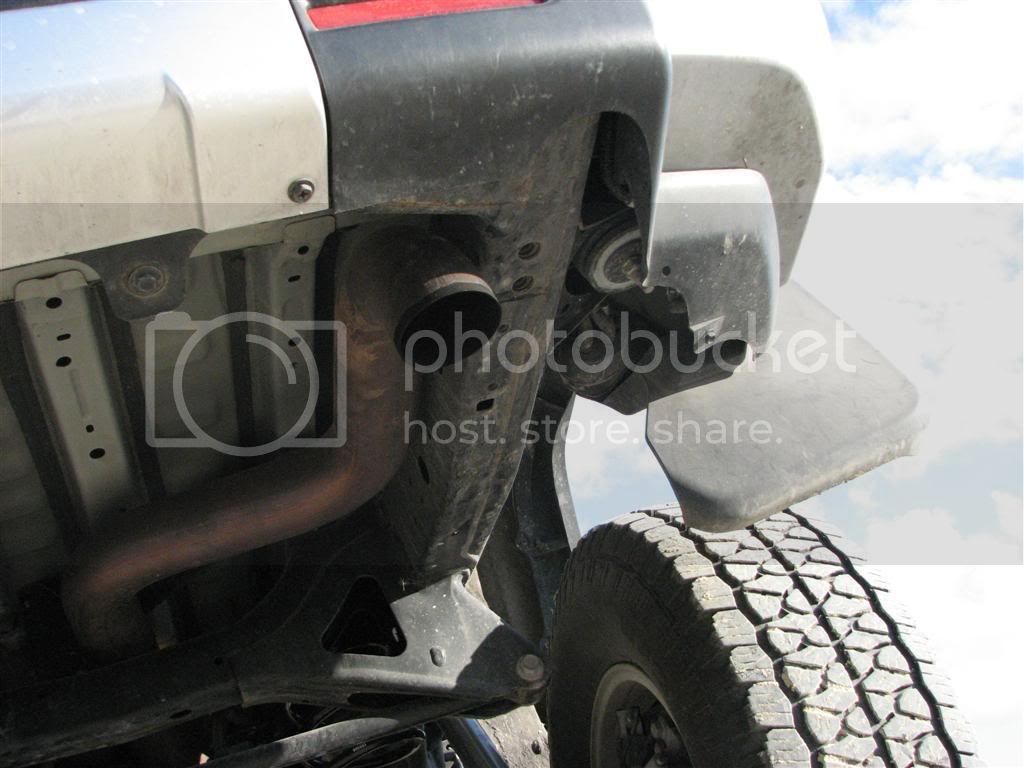

I'm running the stock exhaust... spliced in a flowmaster muffler (flo-952547 super 40)... and chop the tailpipe off and added a 90 degree bend out the side behind the rear tire... This addition keeps rocks from destroying the muffler (thick casing) and from crushing the tailpipe....

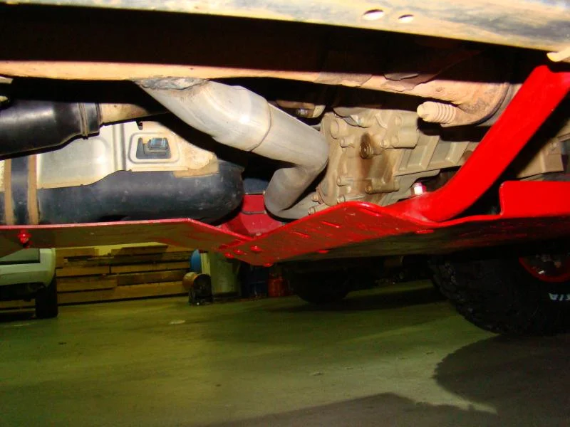

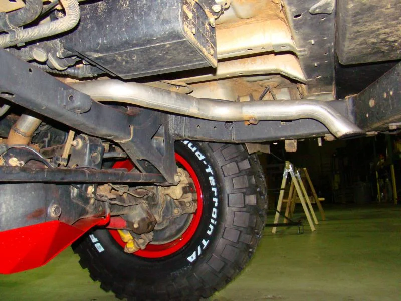

still running stock, but rerouted in two places: behind the t-case instead of under it, and similar to mrbigaxe...high clearance out the back.
^^^ Rick, What set of buds' is that called then, high-tuck ?...
No, it's still the original Budbuilt, but I've beat the snot out of it and hammered it back into submission quite a few times. I added some angle iron to the leading edge which has help tremendously, but the middle kept rattling against the exhaust cross-over (or "-under" depending on how you look at it), so I rerouted the exhaust to keep from abusing it. Now I have a fair gap between the skid and my t-case. Eventually will redo with 1/4" plate, but for now still hammering back into submission after wheeling.
